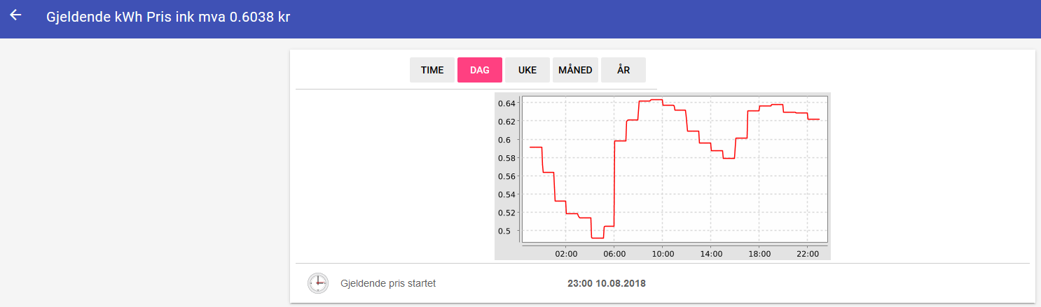

I manage to do this with some help of a friend that made a cron script that runs every minut getting the information with MQTT and JSON.
#!/bin/bash
# Getting data to MQTT broker
data=$(curl \-H "Authorization: Bearer DiNtokenkode" \-H "Content-Type: application/json" \-X POST \-d  '{ "query": "{viewer {homes {currentSubscription {priceInfo {current {total energy tax startsAt }}}}}}" }' https://api.tibber.com/v1-beta/gql)
mosquitto_pub -t /TibberData -m "$data"
Items file.
Number TibberPris "Gjeldende kWh Pris ink mva  [%.4f kr]" <price> {mqtt="<[mosquito:/TibberData:state:JSONPATH($.data.viewer.homes[0].currentSubscription.priceInfo.current.total)]"}
DateTime TibberPrisStartet "Gjeldende pris startet [%1$tH:%1$tM %1$td.%1$tm.%1$tY]" <time> {mqtt="<[mosquito:/TibberData:state:JSONPATH($.data.viewer.homes[0].currentSubscription.priceInfo.current.startsAt)]"}
Hope this helps.
