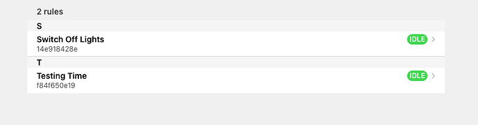

The Rules show a status of Idle. Is that correct?
Yes, it will only show differently when it’s actively running but that’s usually too fast to see in the UI. Or it will show disabled if the rule is disabled.

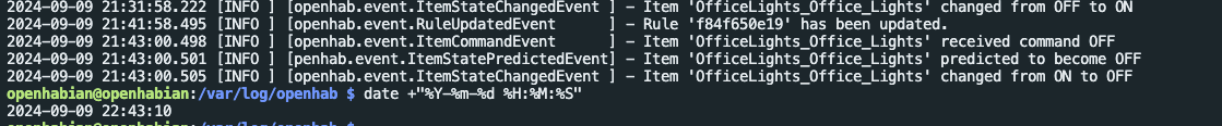

I don’t see anything obviously wrong with the rule. Are you sure a command wasn’t sent to the Item? Have you checked events.log to confirm?
If I click the run button it works but it does not fire on its own when the time is 23:20 or whatever time I set.
OK I figured out what is wrong but not what is creating the issue. There is 1 hour difference between Openhab and my Pi time. Here you can see if I get the system time it is 22:43 but in the log file it is 21:43. So the Rule will fire but I have to subtract 1 hour. My locale is correct and my time zone etc. What could it be?
OK I followed this and the time now seems fine
Checking the timezones was going to be the next step. I’m sure this will fix it and it should work going forward.
