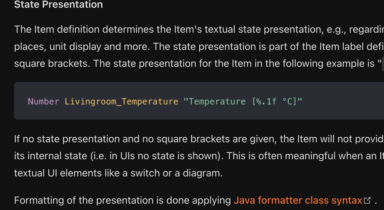

Instead of giving you the answer, I’ll tell you how I got the answer:
If you go to openhab docs Configuration Guide → Items and scroll down to “State”:
you’ll notice a link to Java formatter syntax
Click it, and you’ll go to it, then you read through it… or just do an in-page search for “time format”.
thank you. Appriciate that. I will let you know my results

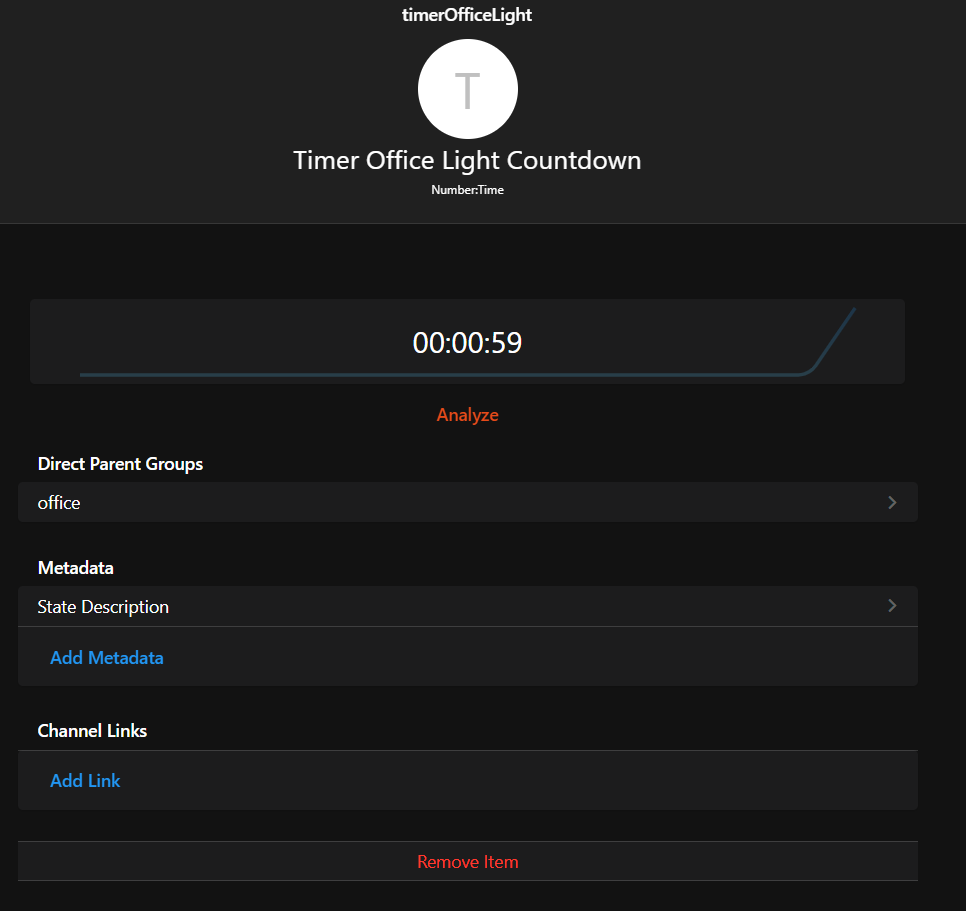

timerOfficeLight is an Number:Time Item
I changed your Timeout item and rename it to timerOfficeLight
In the item language it would be like that:
Number:Time timerOfficeLight "Timer countdown"
In the item configuration the pattern for the State Description is %tT this gives me a nice format.
Unfortunately I do not know how to format it into javascript recognised by the HABPanel widgets. Neither %tT nor HH:mm:SS work :frowning:

    if (RuleOfficeLight.state == ON){
        RuleFlag = true
        if(motionDelayTimer === null) {
            Office_FIBARO_Double_Switch.sendCommand(ON)
            Office_FIBARO_Dimmer.sendCommand(2)
            logInfo("Motion Office", "Movement recognised -> Light ON")
        } else {
            logInfo("Motion Office", "Movement recognised -> Timer stop.")
            motionDelayTimer.cancel
            motionDelayTimer = null
            CountdownItem.postUpdate(0)
    } else{
        logInfo("Motion Office", "Rule deactivated")
rule "Office Motion Sensor OFF"
    Item Office_Multisensor_6_Motion_Alarm changed from ON to OFF
    if(RuleFlag == true) {
        CountdownItem.postUpdate(timeoutMinutes * 60) // reset the timeout
        logInfo("Motion Office", "No more movement -> Timer start.")
        RuleFlag = null
        motionDelayTimer = createTimer(now.plusSeconds(1), [ |
        val timeout = (CountdownItem.state as QuantityType).intValue
        if (timeout == 0) {
            Office_FIBARO_Double_Switch.sendCommand(OFF)
            logInfo("Motion Office", "Timer elapsed -> Light OFF")
        } else {
            CountdownItem.postUpdate(timeout - 1)
            motionDelayTimer.reschedule(now.plusSeconds(1))
    else{
        logInfo("Motion Office", "Rule deactivated already")
For the rrd errors, I don’t know.
Do I see properly that the only condition as a part of code has been changed/removed?
.... || motionDelayTimer.hasTerminated)
