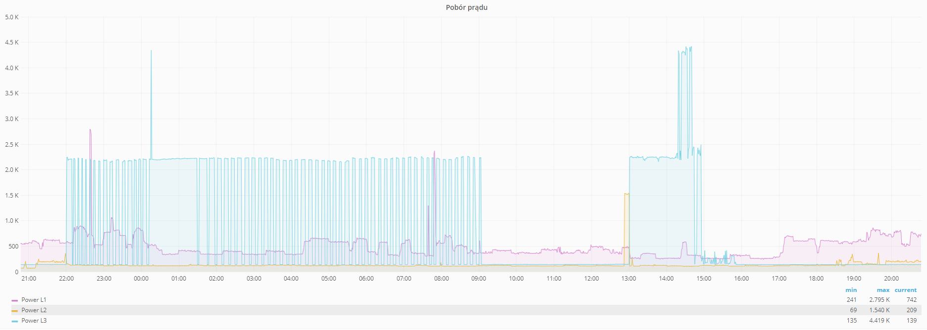

I have graph in grafana, but i don’t know how to get Kwh from Kw to show in openhab the famous ā€œtoday from midnight until nowā€ ā€œlast weekā€ ā€œlast monthā€ ā€œlast yearā€ Kwh total comsuption.

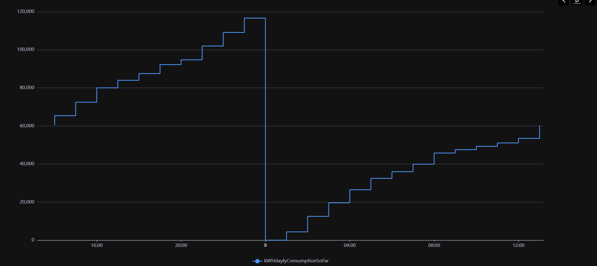

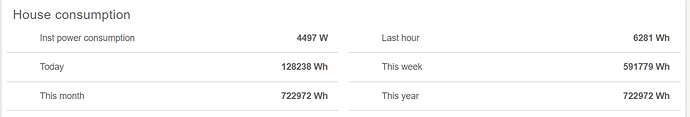

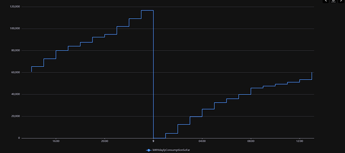

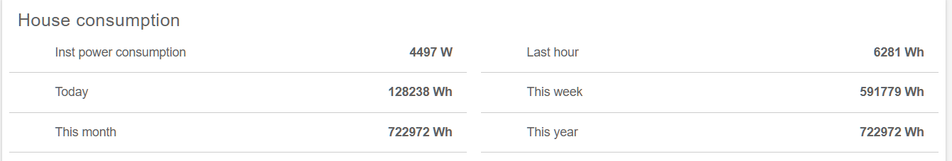

It seems to work fairly well, but I haven’t verified it 100%

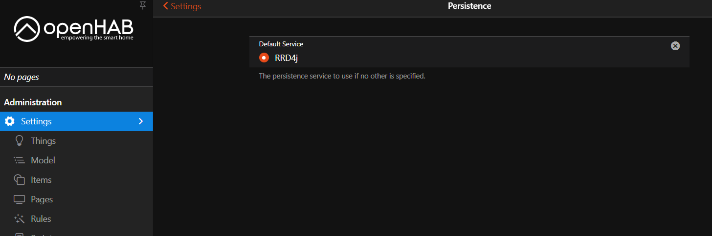

What persistence service have you opted for?
You don’t need influxDB, The ā€˜standard’ RRD4j should work just fine without any further tweaking other than installing and selecting it..

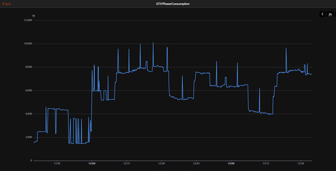

The item holding your instantaneous consumption, kan you obtain an Analysis graph for it?
Here is mine:

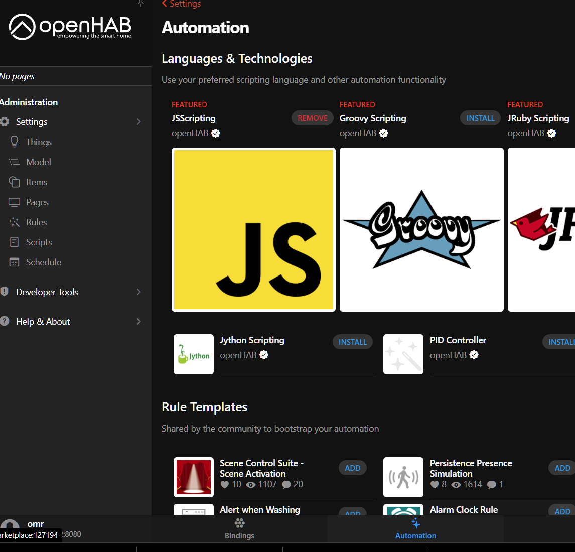

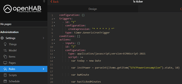

And yes, it is that simple. Just install this: (JSScripting under Automation)

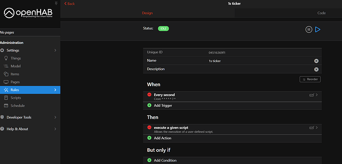

Create a 1s ticker rule, and paste my code into the execute a given script:

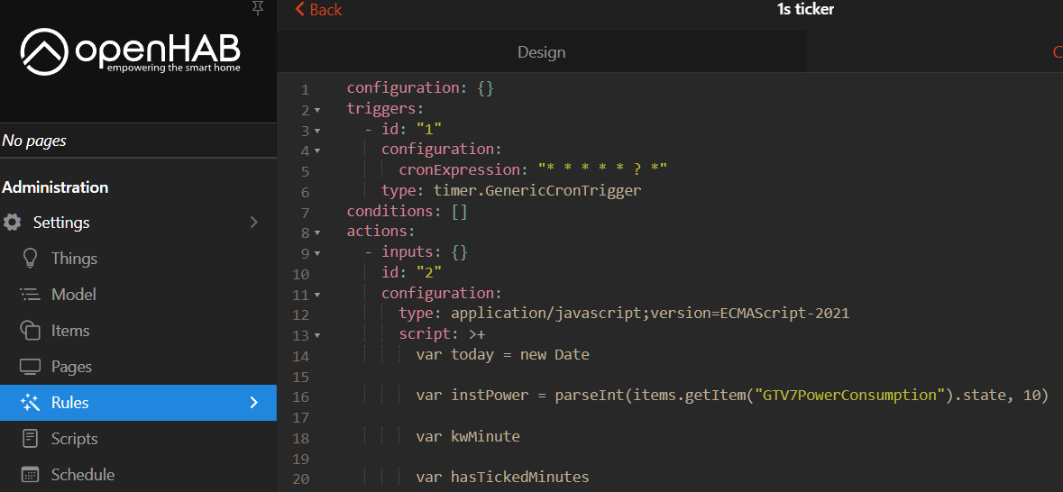

but int he script:
var today = new Date
var instPower = parseInt(items.getItem("GTV7PowerConsumption").state, 10)
var kwMinute
var hasTickedMinutes
if (isNaN(kwMinute)) {
  console.log("Rule starting");
  kwMinute = 0;
  kwHour = 0;
  hasTickedMinutes = false
  hourlyPrice = 0.0
  function isMinuteTick () {
    return (today.getSeconds() == 0)
 function isHourTick () {
   return ((today.getMinutes() == 0) && (today.getSeconds() == 4)) // delay a bit so that the last persisted value becomes part of the sum
    if (isMinuteTick()) {
      if (!hasTickedMinutes) { // sample a full interval
        hasTickedMinutes = true
      } else {
        kwMinute /= 60
        //console.log("kWmin= " + kwMinute);
        items.getItem("kWHminuteConsumption").postUpdate(kwMinute)
        kwMinute = 0
    } else {
        kwMinute += instPower
    if (isHourTick()) {
        var kwPeriod = items.getItem("kWHminuteConsumption").history.sumSince(new Date(new Date().setHours(new Date().getHours()-1))) / 60
        console.log("kWh= " + kwPeriod);
        calcHourlyConsumptionCost(kwPeriod)
        items.getItem("kWHhourlyConsumption").postUpdate(kwPeriod)
        var now = new Date();
        var tday = new Date(now.getFullYear(), now.getMonth(), now.getDate());
        var lastMonday = new Date(tday.setDate(tday.getDate()-(today.getDay() + 6) % 7));
        var daySoFar = items.getItem("kWHminuteConsumption").history.sumSince(new Date(new Date().setHours(0, 0, 0))) / 60     // from midnight
        var weekSoFar = items.getItem("kWHminuteConsumption").history.sumSince(lastMonday) / 60                                // from midnight monday
        var monthSoFar = items.getItem("kWHminuteConsumption").history.sumSince(new Date(new Date().setDate(1))) / 60    // from the 1. of the month
        var yearSoFar = items.getItem("kWHminuteConsumption").history.sumSince(new Date(new Date().setMonth(0, 1))) / 60 // from 1. january
        items.getItem("kWHdaylyConsumptionSoFar").postUpdate(daySoFar)
        items.getItem("kWHweeklyConsumptionSoFar").postUpdate(weekSoFar)
        items.getItem("kWHmonthlyConsumptionSoFar").postUpdate(monthSoFar)
        items.getItem("kWHyearlyConsumptionSoFar").postUpdate(yearSoFar)
which objects do i need to replace to match my items provided by my energy meter?

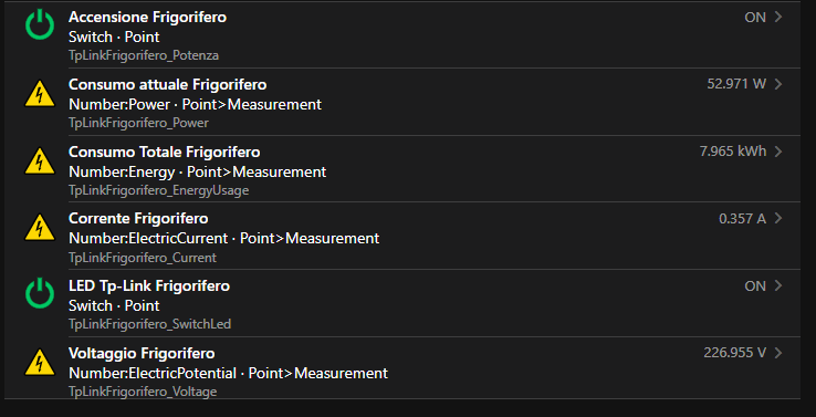

actually i have these:
the item ā€œ_EnergyUsageā€ is the total of energy consumed from when the device has been turned on, and item ā€œ_Powerā€ is the live consuming.

forgot, jss scripting installed and yes i use RRD4j persistance.

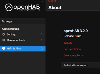

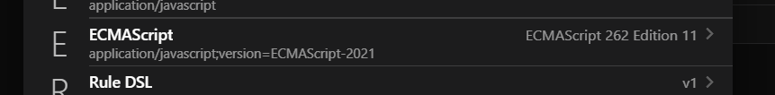

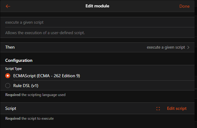

Hmm, are you sure you are on OH 3.2.0 release or newer?

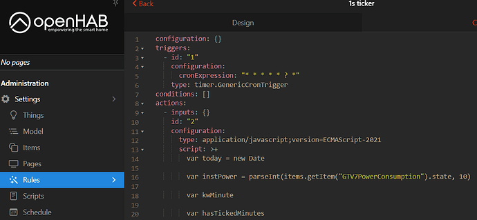

You must choose the latest ECMA as rule.
The only thing you should need to change is:
to
var instPower = parseInt(items.getItem("TpLinkFrigorifero_Power").state, 10)
See JavaScript Scripting - Automation | openHAB

yes i’m only using openhabian and maybe is not updated much more than 2 weeks…

Check your version:
Could you have been hit with this?
Also verify that you got the ECMA 2021 type:
nope, 3.1.1 and no description for ecma scripc version… :frowning:
i’m trying to update to 3.2.0.
downloading in progress, when ends i’ll update you.
now i’m fully updated with OH3 3.2.0 and ECMA rules match with your.
the error still persist…
after oversaving the rule it started to wor! thanks!
one other question: i get the minuteconsumption with value, but not hourly and so on. it will be compiled after hour change?
Glad you got it working. You are set for the future :slight_smile:
Yes.
if (isHourTick()) {
will trigger when Date (aka clock) is xx:00:00 ie min=0 & sec=0 aka every hour.
If, for some reason, your system fails to detect the xx:00:00 tick, make another rule triggering every hour, and move the appropriate code over.
Again thanks a lot for your help!!!
I had to comment ā€œcostā€ because make errors on execution of the rule.
Btw,i suppose you set a static cost for energy and could be multiplied for consumption?
And need to be created a monthly cost as item?
Thanks again!
