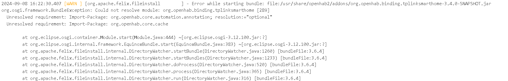

I tried removing the above binding from my config file and putting the jar file in the addon directory and got this message in the log.
Am I doing something wrong? Never user jar files before
