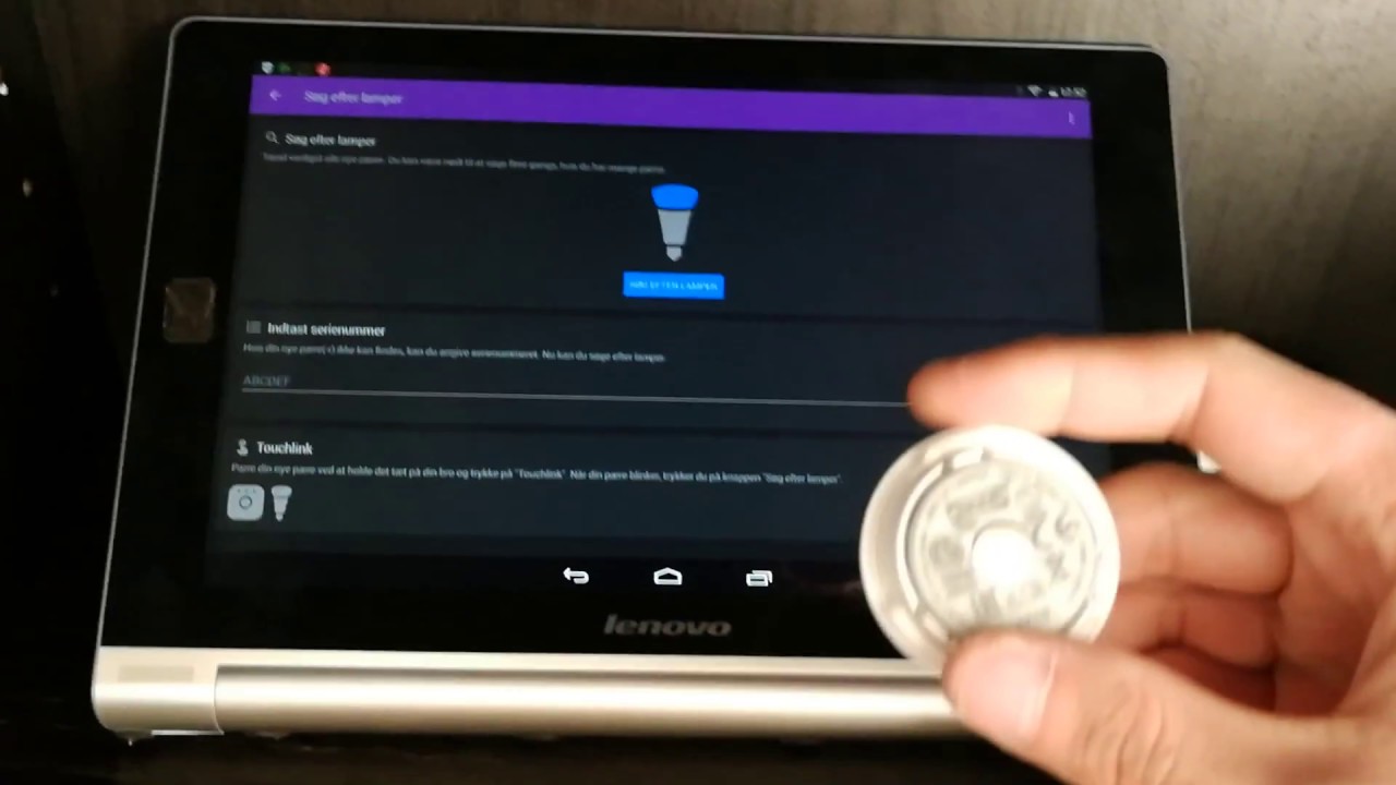

The most important information, how to get the thing to bind, can not to be found in the official manual but in the Using IKEA TRÅDFRI remote on Philips Hue system with bridge video posted above.
To get the remote into paring mode you need to press the pair button 4 times relatively quickly. The red LED blinks red shortly if you are successful. This was the case for me on firmware 11115720. Can I update the firmware without an Ikea gateway?

Tried it via the way showed in the video and it works for me perfectly since months.
Needed about 10 times to connect the remote to the hue controller.
