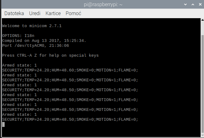

I went to check if serial port recieved anything with:
sudo minicom -b 9600 -o -D /dev/ttyACM0
This is recieved output:
ex.
SECURITY;TEMP=25.00;HUM=48.00;SMOKE=1;MOTION=0;FLAME=1;

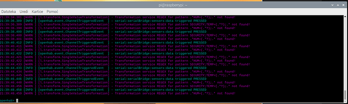

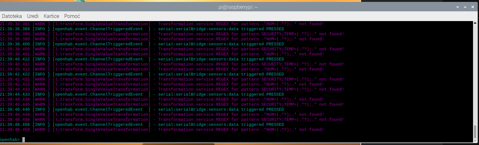

This is what logs said:
I don’t know what’s wrong with regular expressions because I simulated them and they looked okay.

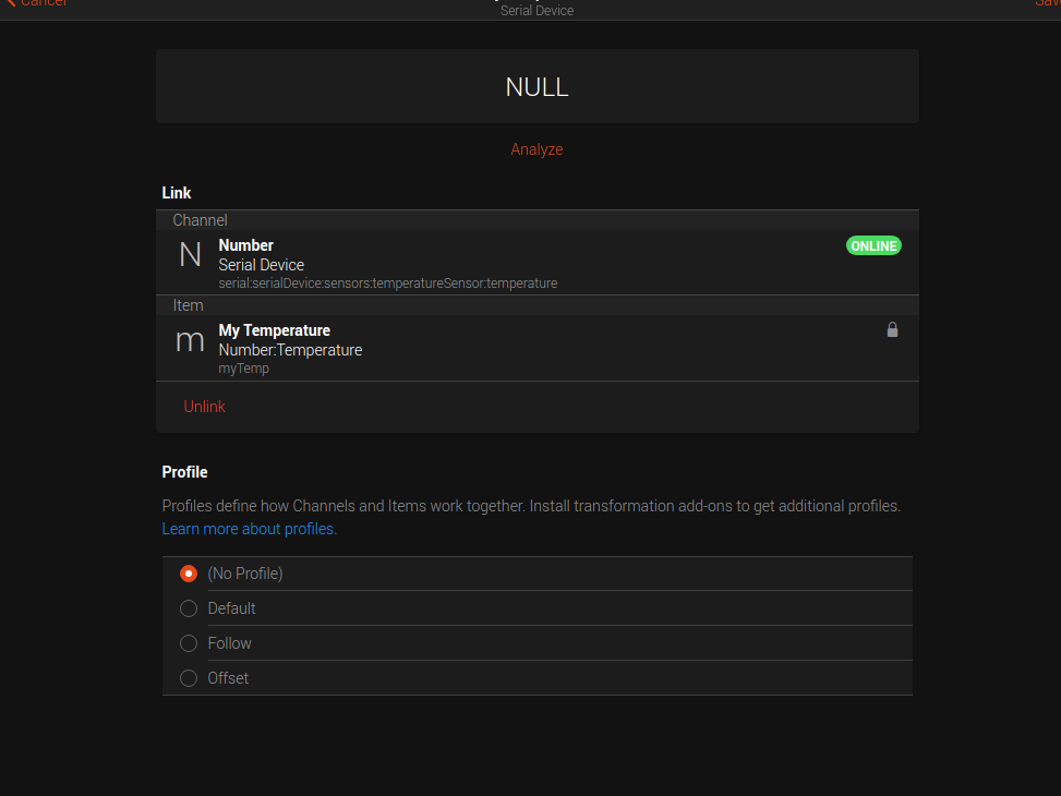

I tried adding this line in .items file and Arduino item was NULL as well.
String Arduino "Arduino [%s]" (arduino) {serial="/dev/ttyACM0"}

This is a configuration for version 1 Serial binding, which is not available in openHAB version 3.
The error message tells you that the REGEX Transformation service cannot be found.
It’s an optional add-on, and needs installing.
