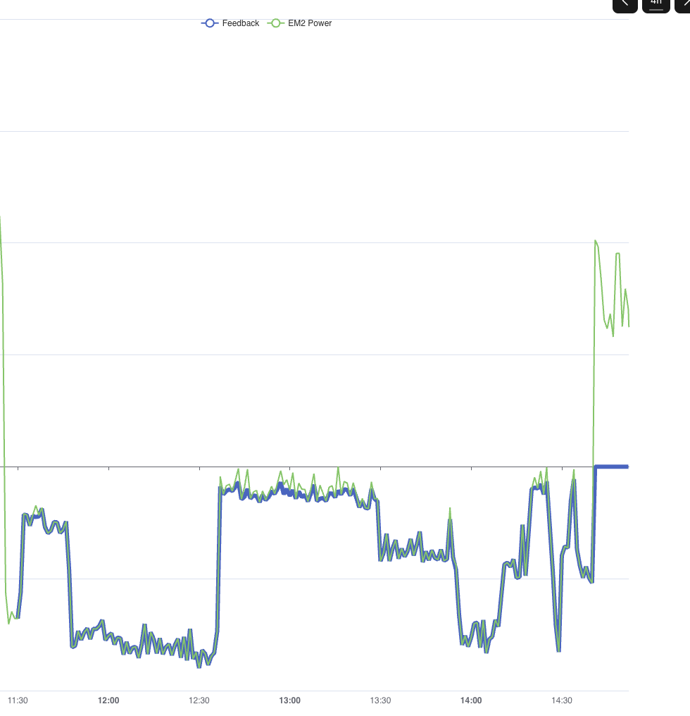

In this case there is a Smart Meter (an EM2 with Tasmota software but not 100% relevant) and this meter measures the the power and when it goes to the inverter (insufficient demand ) the value goes negative - how to handle that
First thought - Easy create a rule on update to EM2_power0 and when its negative update the new Item (i called it c_inverterFeedbackFlow) with the negative value and include that Item in whichever group is needed -
actually turned out to be far simpler - I created a new Item and linked it to the Power0 of the EM2 and when I went to link it and choose the SCRIPT Ruby Profile
i added this ruby script to the “Thing to Item Transformation”
|(input = input.to_f) > 0 ? 0 : input
Basically it says if the value is greater than 0 set the Item(c_inverterFeedbackFlow) to 0 or if its negative make it the value of the Channel.
I just add that new Item to the group for the Consumption calculation and I can also show the item it separately in the UI as needed - no need to have a rule triggered every time the field is updated.

Thanks for posting! It’s always great to see new tutorials.
Just note that this doesn’t make the transformation any more effecient than doing this in a rule. The script engine still needs to process the jRuby code.
But it is a bit more stramlined and ends up creating fewer events on the event bus as it runs between the Channel update and the Item update. So it’s Channel → Transformation → Item instead of Channel → Item → Rule → Item.
