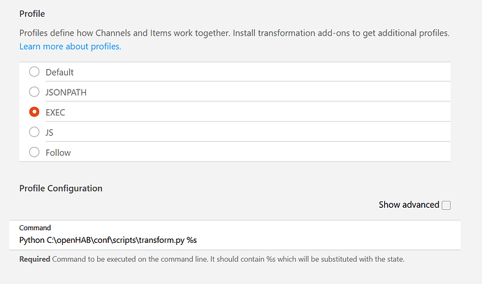

@timl where I placed the command was in profile configuration for the item where it has the exec profile option and a box for command, will this not work?
Hmm… profile? The command in the Thing configuration and the Whitelist ( Exec - Bindings | openHAB ) have to be 1:1 the same. Otherwise the Thing could not execute the command.
I was trying to follow Exec - Transformation Services | openHAB.
So I created a new thing from the exec binding and placed the same command in the thing config and the whitelist file. What I’m trying to do is whenver the value of item changes, I would like the command to run and change the value with the script output.
This is where I placed the command:
which should work like a transformation and replace the value right? but it’s not working
What @timl is saying by 1 to 1 is the whitelist line must match character for character, including case. With this screen shot the whitelist entry must be exactly
Python C:\openHAB\conf\scripts\transform.py %s
The whole command needs to be there, including the %s.
You might need to double escape those back slashes if that doesn’t work. I’ve never see people use the Exec transformation on Windows, and it’s rarely used at all by others. There is very little reason to do so and it’s really heavy weight.

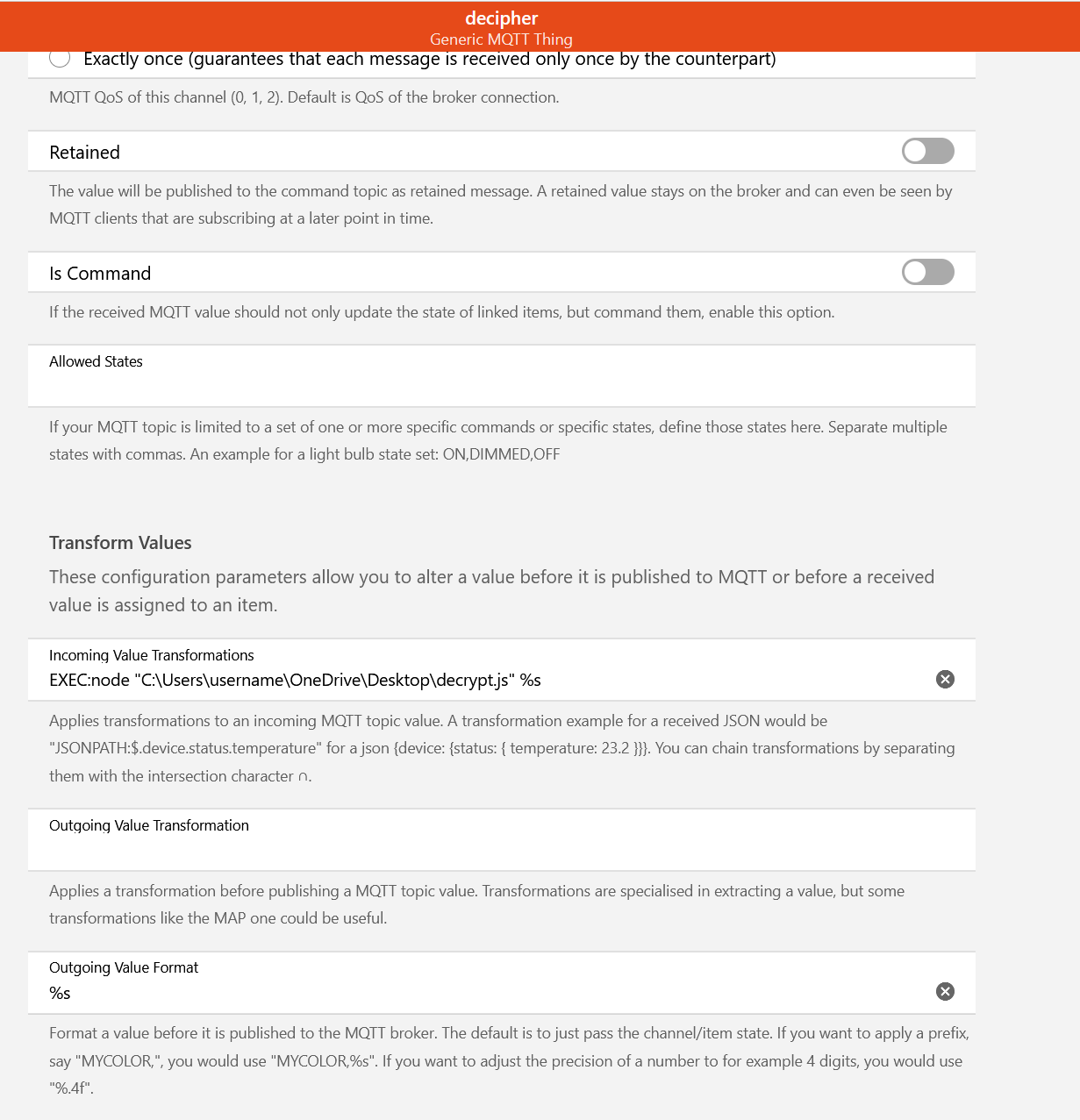

So in the UI in channel configuration
for incoming value transformation I have this:
node "C:\Users\username\OneDrive\Desktop\decrypt.js" %s
and I have the exact same thing in whitelist, copy pasted. But I get this error again:
Tried to execute 'node "C:\Users\username\OneDrive\Desktop\decrypt.js" %s', but it is not contained in whitelist.
Any ideas?
Well, as I mentioned on the other thread or maybe it was here (that’s why we prefer to only open one topic on a given issue) because you are on Windows you may need to escape the backslashes. Or you can try to use forward slashes which Java knows how to interpret even for Windows paths.
C:\\Users\\username\\OneDrive\\...
