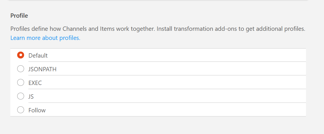

Profile is default

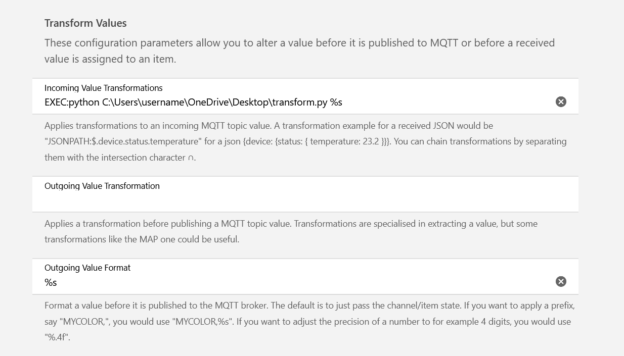

Tbh it’d be much better if the exec mqtt incoming msg transformation worked but it just wont execute commands :frowning: I have no idea why
@rlkoshak just to confirm, in my channel configuration for transformation i have
Is there a way to use execute command line here with exec? Is the command typed in the correct way to be executed correctly? Is this and the whitelist the only two places where the command needs to be?

No, it’s a rule action, only available in rules.
Have you tried giving it the full path to python or node? In general openHAB doesn’t get a full shell environment. What you have on the terminal may not be available to OH when it runs the command.
