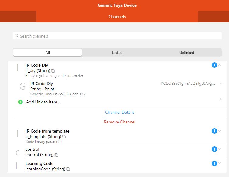

Tuya IR Controller
Based on SmartHome/J Tuya Binding
Added ability to send IR-codes localy.
Also support NEC-format codes and instruction below not may not be relevant
Now just use a NEC-format code if your remote control sends codes in this format )))
For others formats use instruction.
Added continuous learning mode option
Small instruction is here, unfortunately, on russian
PR to added support of Tuya IR Controller by d51x · Pull Request #471 · smarthomej/addons · GitHub

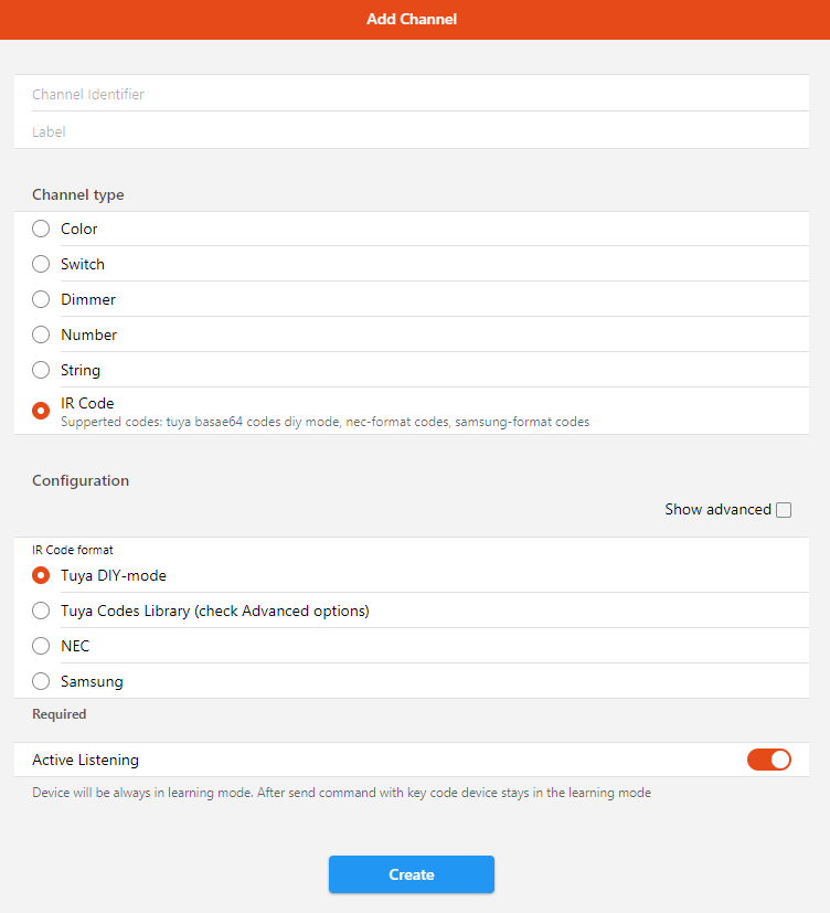

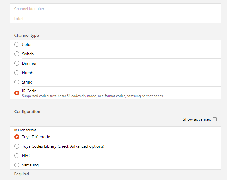

Updated.
Added NEC-format codes support for sending to device

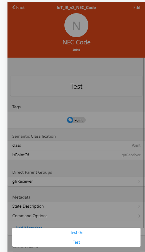

Command option and State Description
Example, from Tasmota you need to use Data parameter, it can be with or without 0x
{"Time": "2023-07-05T18:17:42", "IrReceived": {"Protocol": "NEC", "Bits": 32, "Data": "0x10EFD02F"}}
Another example, use hex parameter
{ "type": "nec", "uint32": 284151855, "address": 8, "data": 11, "hex": "10EFD02F" }
