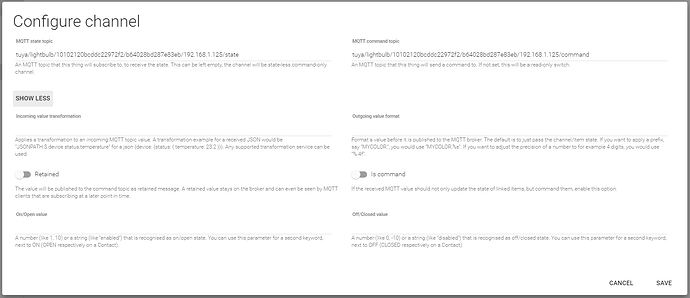

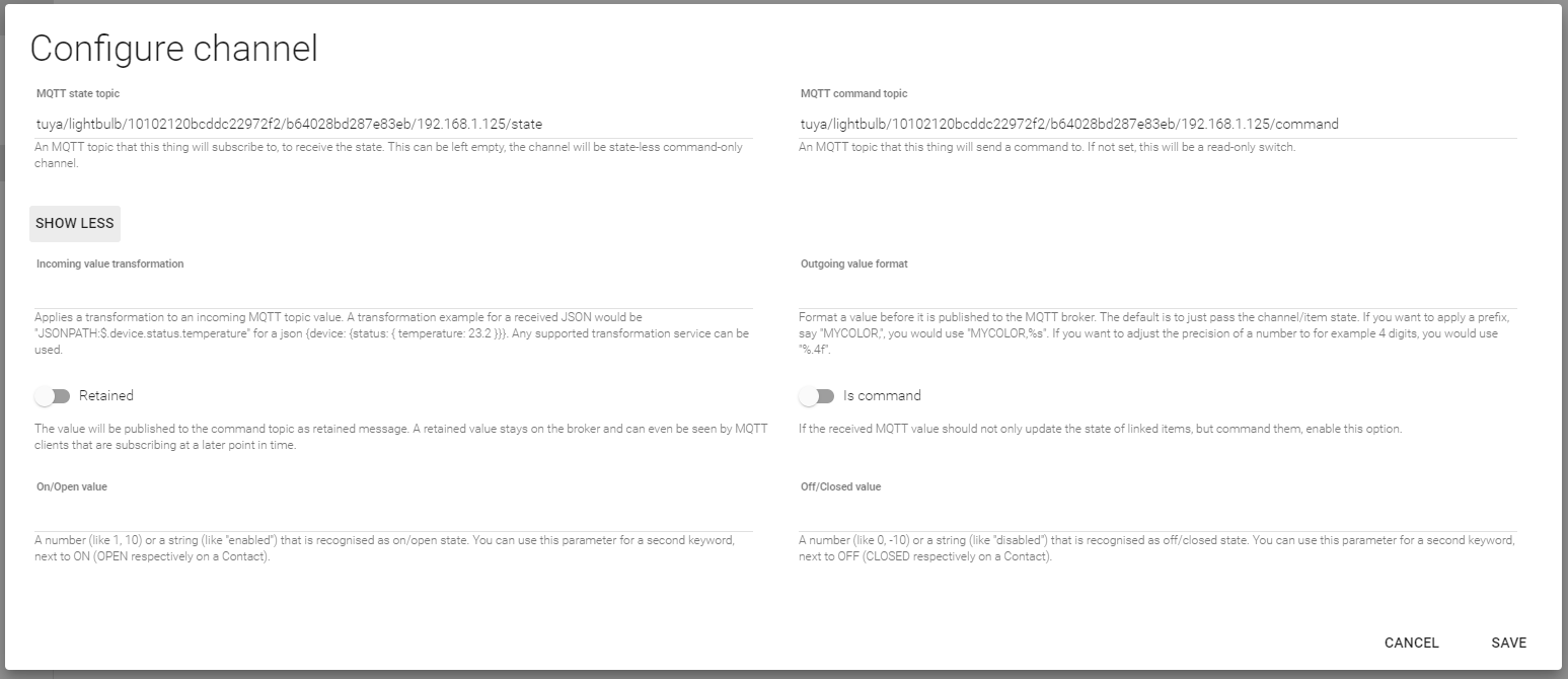

From memory I used:
tuya/lightbulb/uuid/localkey/localIP/state
And
tuya/lightbulb/uuid/localkey/localIP/command
I can post screenshots when home. Thank you for continuing to offer assistance.
I had forgotten that I used my phone to collect the uuid and key. This is what they look like.
tuya/lightbulb/10102120bcddc22972f2/b64028bd287e83eb/192.168.1.125/state
And
tuya/lightbulb/10102120bcddc22972f2/b64028bd287e83eb/192.168.1.125/command
