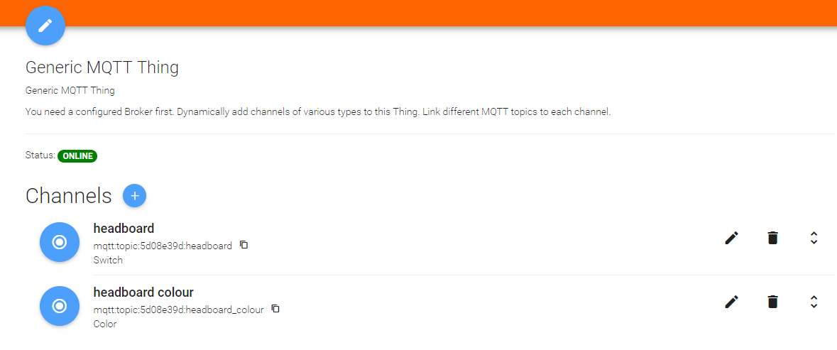

I have openhabian 2.4 installed on an RPi 3B+
I have the “misc-mqttbroker - 2.4.0” embedded MQTT broker installed and the “binding-mqtt - 2.4.0” MQTT binding. To the best of my knowledge the Thing I’ve made is online and fine, as reported by PaperUI.
Ignoring the colour channel/item pair for now. I’ve made a channel for the light, named headboard, and linked to a switch. I don’t think that warrants a picture. There’s a lot of extra detail in this part about getting the UUID/localkey pair of the light but I’m confident that’s fine.
Where I come unstuck is troubleshooting from here. Part of the process involves this project:
TheAgentK’s tuya-mqtt bridge
I’m inclined to think that my problem lies here, with my MQTT messages going through but never being translated properly. I just don’t understand the inner workings here; I find it difficult to grasp the programming side of things.
