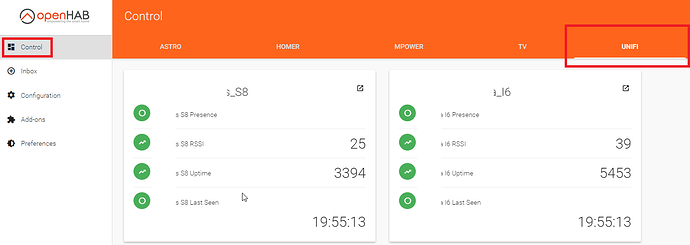

both are correct. The @Unifi part just adds another tab in the control section of PaperUI and it’s optional

Here is my example config:
/etc/openhab2/things/Unifi.things
Bridge unifi:controller:Unifi_HomeR "Unifi Controller: HomeR" @ "Unifi" [host="172.16.13.100", username="xxxxxx", password="yyyy", port=8443, refresh=10]
Thing client XXXXXs_S8 "XXXXXs_S8" @ "Unifi" [mac="04:d6:aa:87:4c:25", site="default"]
Thing client YYYYYa_I6 "YYYYYa_I6" @ "Unifi" [mac="a8:66:7f:e3:ac:ca", site="default"]
/etc/openhab2/items/Unifi.items
Contact XXXXXs_S8_PRES "XXXXXs S8 Presence [MAP(Unifi.map):%s]" <switch> (gUnifi) {channel="unifi:client:Unifi_HomeR:XXXXXs_S8:online"}
Number XXXXXs_S8_RSSI "XXXXXs S8 RSSI [%s]" <qualityofservice> (gUnifi) {channel="unifi:client:Unifi_HomeR:XXXXXs_S8:rssi"}
Number XXXXXs_S8_UPTM "XXXXXs S8 Uptime [%d]" <time> (gUnifi) {channel="unifi:client:Unifi_HomeR:XXXXXs_S8:uptime"}
DateTime XXXXXs_S8_TIME "XXXXXs S8 Last Seen [%1$tH:%1$tM:%1$tS]" <time> (gUnifi) {channel="unifi:client:Unifi_HomeR:XXXXXs_S8:lastSeen"}
Contact YYYYYa_I6_PRES "YYYYYa I6 Presence [MAP(Unifi.map):%s]" <switch> (gUnifi) {channel="unifi:client:Unifi_HomeR:YYYYYa_I6:online"}
Number YYYYYa_I6_RSSI "YYYYYa I6 RSSI [%s]" <qualityofservice> (gUnifi) {channel="unifi:client:Unifi_HomeR:YYYYYa_I6:rssi"}
Number YYYYYa_I6_UPTM "YYYYYa I6 Uptime [%d]" <time> (gUnifi) {channel="unifi:client:Unifi_HomeR:YYYYYa_I6:uptime"}
DateTime YYYYYa_I6_TIME "YYYYYa I6 Last Seen [%1$tH:%1$tM:%1$tS]" <time> (gUnifi) {channel="unifi:client:Unifi_HomeR:YYYYYa_I6:lastSeen"}
/etc/openhab2/transform/Unifi.map
OPEN=Away
CLOSED=Home
NULL=Unknown
