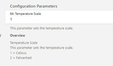

I am trying to edit the label for any zwave thing or its configuration parameters for example, change temperature scale of this temperature sensor.
It doesn’t matter whether it is battery or main powered and the things are online and working properly but changing the parameters of any zwave thing does not work. On the other hand I am able to edit any linked channel and items.

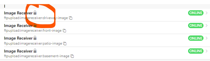

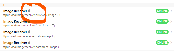

The only times I have been unable to edit in the UI is if there is a Lock because the thing was defined as a file.
