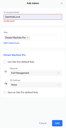

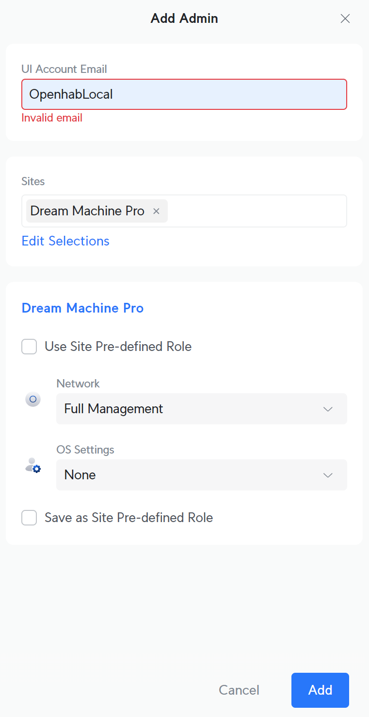

Not sure how to handle, it forces me to use an email address for a new account on my Dream Machine Pro!?
Instead of the site management I could also find user roles in the OS settings. I added a local user but get errors within unifi:

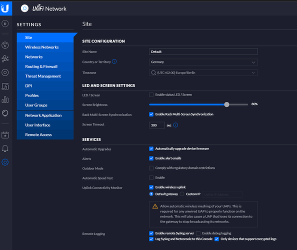

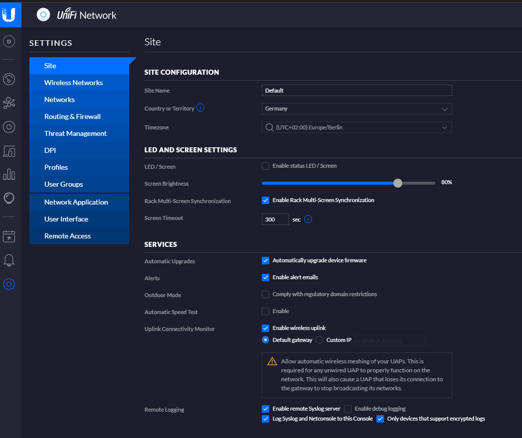

I’ve never set up a user on the phone app. I’ve always used the web browser interface. On the Legacy user interface, I set it up under Settings->Admins. I give the user the role “Administrator”.
It has been the browser on a pc, not the app. How do you access the legacy interface?
Select System from the left menu bar, then select the Advanced tab. Change the Interface setting from New to Legacy.
Now you should see the Admins option on the left menu bar.

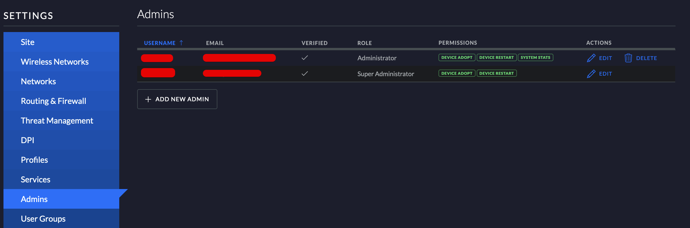

So in legacy UI, you don’t see an option for Admins like this?
unifi-admins
I run into the same problem. Can’t find any settings to create local admin with 8.2.93

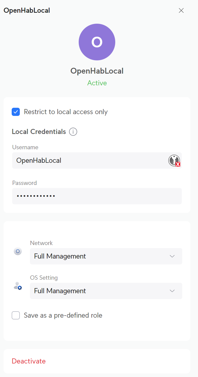

I also have some problem with the unifi binding and authorization. I was able to create a user with “restricted to local access only” and give it the “Super Admin” role.
With that user I can interact with my unifi channels at the beginning. But after some time I again get the message “Not Authorized! Please make sure your controller credentials have administrator rights”
When I disable the “Unifi Controller” thing in openhab and reenable it, everything works fine. But after some time the error is back
Does anyone have an idea what could cause this?
