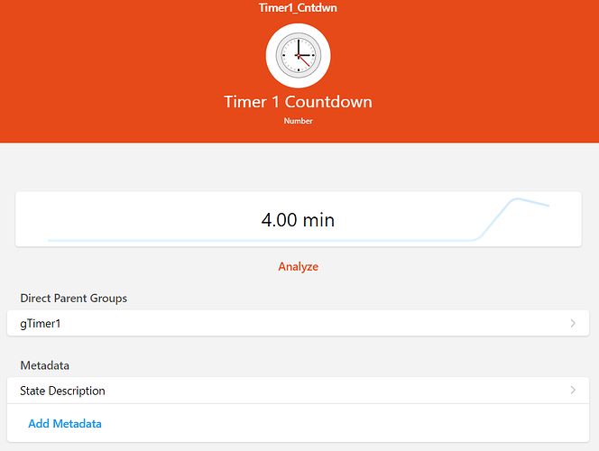

Number I am trying to convert in gui is shown in the image, I don’t know of another way to capture the full view of an item configurations. I do have the JS scripting installed under automation.

A Number:Time Item can be formatted the same as a DateTime to get HH:MM:SS formatting.. Something like %1$tH:%1$tM:%1$tS in the state description will break the time up into hours:minutes:seconds.
See Items | openHAB. You can include a transformation as part of the state description pattern. But if you have a Number:Time it’s not necessary. Use DateTime formatting and as long as the time isn’t larger than 30 days it will work just fine.
Thanks, that worked. I guess I had my blinders on and got caught in keeping same type of variables.
