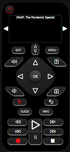

Hello all,
Basically I am working to create a single virtual universal remote widget to control everything in my home theatre setup (Projector/Receiver/KODI mainly today). I stumbled across and built upon this excellent Harmony widget as a starting point for my first custom widget (thanks a lot to @craigers and @matt1 here!):
https://community.openhab.org/t/oh3-harmony-widget/112172/7?u=d0t

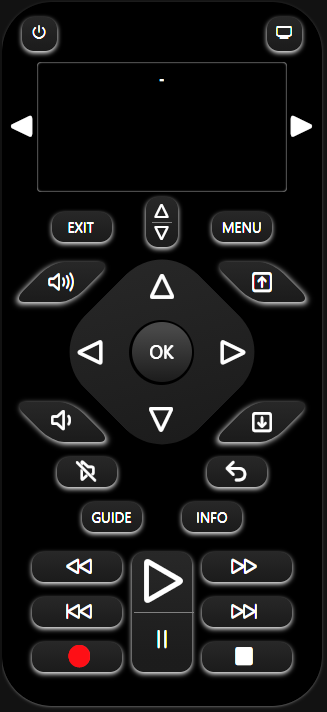

To get started I was able to rapidly modify the widgets in the thread above, add some additional configurations, and create a single remote that could do mostly what I was after - controlling KODI for playback/pause/stop, and a rule for the power button which would power on/off both the PC/Receiver/BenQ Projector (thanks @mlobstein!), and have volume/mute controlled by the Receiver. It was relatively easy to wire in via YAML and control a set of devices/items mapped in the widgets config, by adding new Widget config options (Props > Parameters) for the items I wanted to control. But is it possible to dynamically switch Props configuration within a Widget, based on other options?
For example, in my screenshot below, I’d like the Screen button in the top right and corner popup and allow the user to select the device they want to control (defined when ‘picking’ which things to control in the Widget config), so its possible to more generically control and navigate through each devices menus using the same virtual remote/buttons. At the same time, I understand how this can ‘break down’ quick as you consider the many different types of things/items/states and how the mapping could be very different… And It’s unclear to me if handling such mappings are even possible today within the Widget definition itself, beyond just picking items. (i.e. ideally nesting of the configuration so that the selected device could map all Widget buttons to a different set of items)

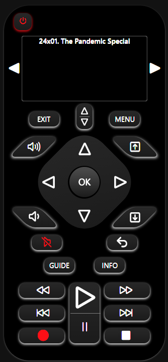

After heavily revising the UI, here is where I am currently at, which was strongly inspired by my favorite physical remote - the Harmony One:
For you OH3 UI Widget guru’s out there - would you recommend that I just continue forward with one to one mappings for each button/item in the Widget configuration and drop the thought of device switching for now?

Your remote looks good already. And the goal to make it more universal by adding not only routines but devices as well will give you/us a great widget. Hope you can make it and get the support here, if you need it. I can’t give technical help (OH-beginner) but maybe give feedback when it comes to functionality.
Here is a pic of the latest version of this widget - which utilizes some layout and styling cues from the Harmony Elite…
All ears for any and all feedback here. Working to design the IDEAL virtual remote control for your home theatre, too! :slight_smile:
After studying all of the nuances between things/items/states, I decided to go for the one-to-one mappings between buttons & items to start; maybe in the future I’ll break down and just buy the Harmony Elite & Hub to handle the rest to make this truly ‘Universal’ - the easier way forward. Here is my latest code which works pretty darn good already, assuming your using KODI as the Media Player. A few notes:
  • For volume/mute/power controls, you may need to tweak the ActionCommand’s within the Widgets YML for your setup (i.e. the state/command your items/hardware expects).
  • Some KODI addons are a little quirky for how they update the OH items states.
  • The virtual screen needs better handling of ‘undefined’ when everything is powered off.
  • The virtual screen left/right buttons don’t do anything useful, yet…
Otherwise, this has been working great for my personal needs overall! The screenshot:
And finally, here is the latest working Widget YAML code! Eventually I’ll get this into a github repo, but here now for initial release:
