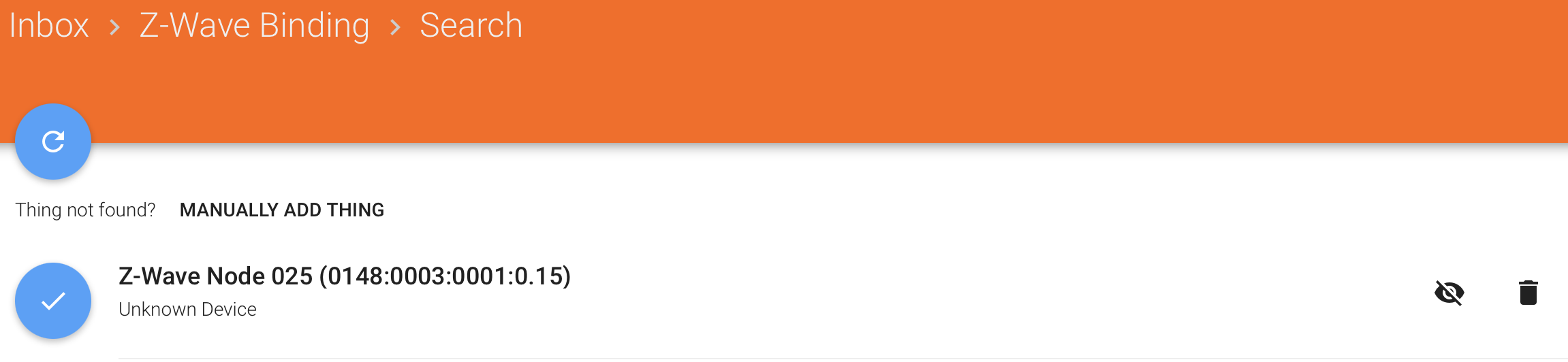

I wanted to change a configuration setting of one of my Spirits and discovered in Habmin, that all of them were grey with a delete button. I have not discovered any disfunction on them so far.
Since I thought there might be a change in the binding wich needs to remove and redetect this devices I deleted nodes 25 and 28. Then I started discovering in Paper UI. The nodes were discovered directly, but only as Unknown Device. I added them again and hoped it will change, but they are still Unknown.
If I look at the properties of the Unknown Device, it looks somehow alright to me. I have no idea, why it’s not discovered anymore in the right way.
Somehow strange in my opinion is, that I can not find anything about node 25 and 28 in the zwave.log. I see conversation with the nodes I did not delete so far, but not with the readded ones, even during the adding of node 25 there is noting about it in the logs.

Discovered node 25:

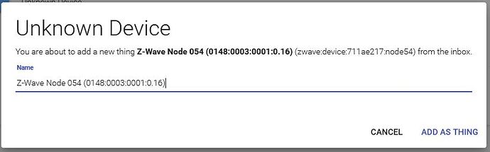

I have exactly the sam problem. I have only one of these devices. It just stopped working and cannot re-add it anymore.
and don’t know what to do with it.
Device is in database and it was working just fine but stopped.
