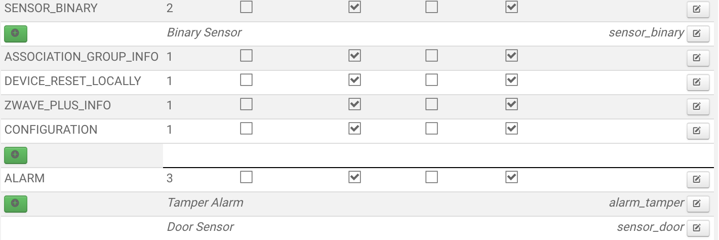

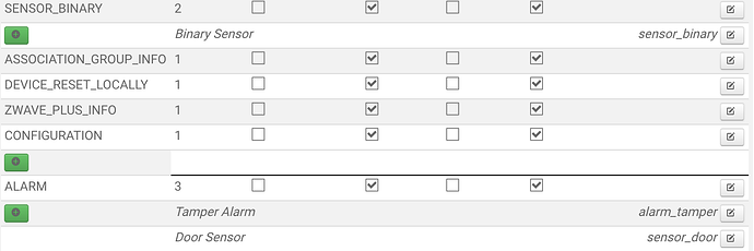

I’ve changed the channels slightly - I re-added the sensor_door to the Alarm command class (this was in one of the two entries previously). I checked one of the XML files that was previously loaded and it showed that this is reported.
From the XML, we have events 22 and 23 which are the door/window events -:

Tamper is not actually shown here, but I’ve left it in the database definition.
We now have -:
Thx. I picked the one with the channel definitions from your last change, assuming those are the correct ones. :grinning:

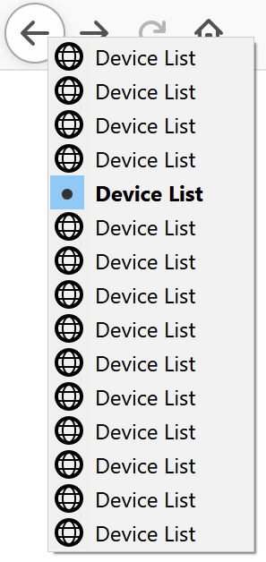

Every. Single. Page. is labeled simply “Device List”. That doesn’t help.
Useful BACK button, yes? :roll_eyes:

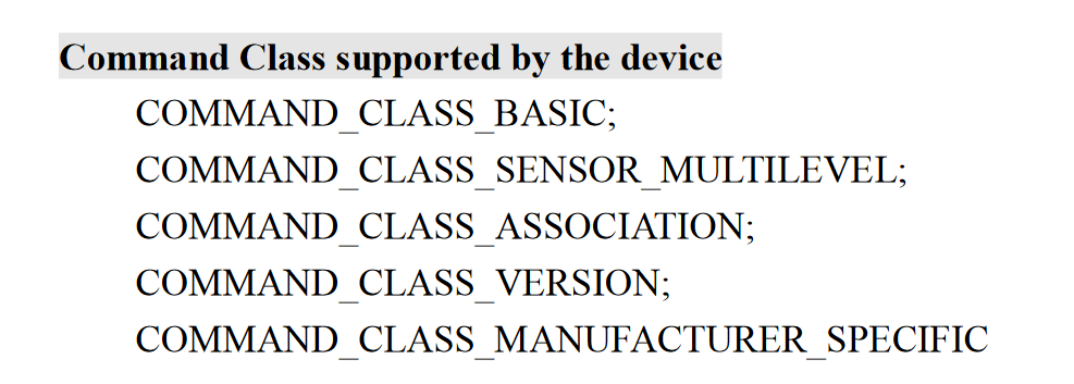

I found a newer manual which still doesn’t mention the configuration command class, but does list config parameters.
I also tried to find this device in the zwave alliance database, but couldn’t.
Given that the new manual specifically mentions ZWave Plus Technology, where the old one only says ZWave Technology, they are probably different, and probably it’s therefore best to split them.

@chris, I checked the manual you linked to and found the following on page 5:
Isn’t that it?
My version of the manual (the one I uploaded) has it too.
