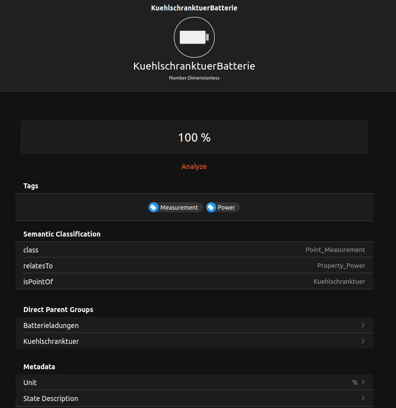

The MQTT value is 100. If i don’t set UoM i get 100 one.
I set Unit meta data % and get this:
grafik

1 ONE = 100 %.
The state of the Item is 1 ONE. When the value from MQTT is posted to the Item, it’s converted from 100 % to 1 ONE. On the UI, it’s converted from 1 ONE back to 100 % based on the state description pattern.
Then you need to change the Item’s unit metadata to %. That’s the only way to cause the Item to carry the value as a % instead of ONE.
Note: ONE is the only unit that isn’t printed when using units of measurement.
Thanks Rich for your clarification. I set unit metadata to % but nothing happens. After update of item it set it now as expected.
Yes, I forgot to mention that part. Changes to the unit metadata won’t actually take effect until the Item is updated.
