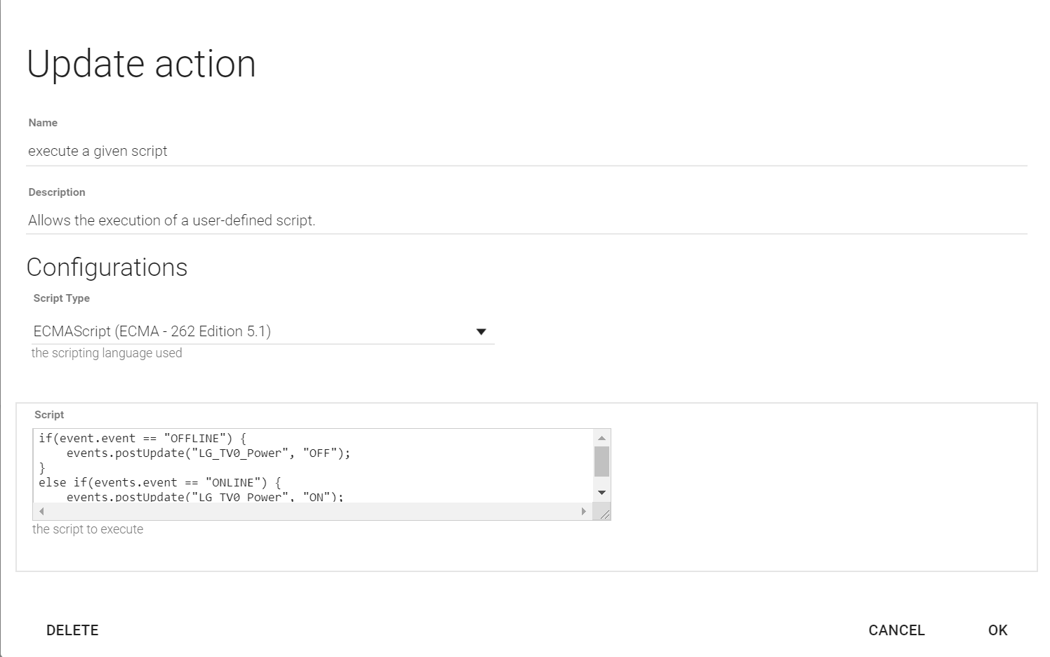

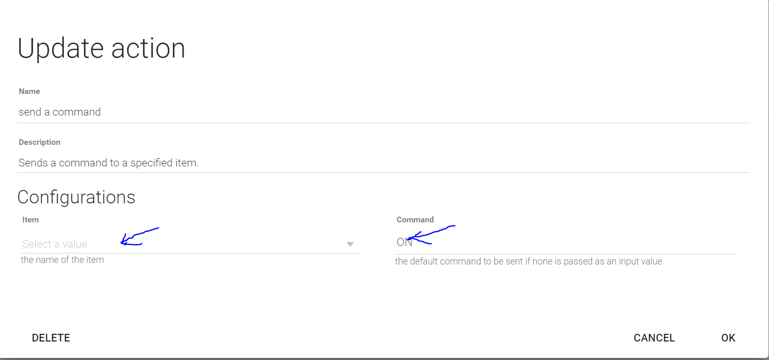

You don’t have the option to send a state change to an item in the ngre, that I could find…

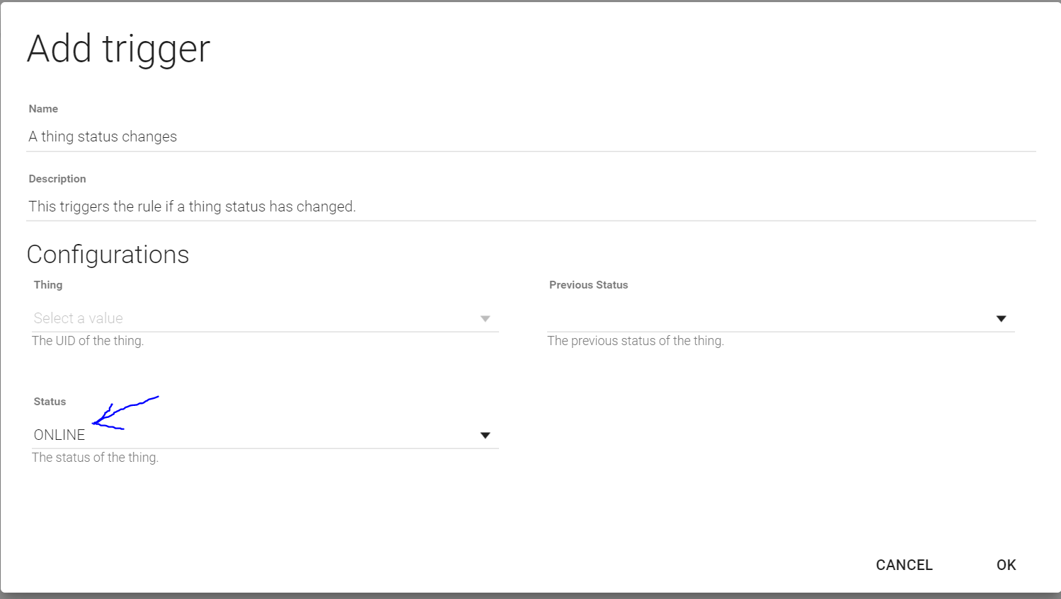

- “When…” The Channel changes to OFFLINE
- “then…” send command to your Item
Repeat the two steps above for OFFLINE and OFF.
Or you can write it in JavaScript (or Python or any other supported and installed language).
trigger the same as above only don’t fill in the Status, leave that blank. \

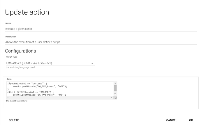

Choose the “execute a given script” action
if(event.event == "OFFLINE") {
events.postUpdate("LG_TV0_Power", "OFF");
else if(event.event == "ONLINE") {
events.postUpdate("LG_TV0_Power", "ON");

No option to change an item’s State under #2
Can send a command, but not what im trying to accomplish
