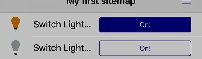

For the lights, this is working perfect in BasicUI and I’m getting updates to the state when a physical button sets the light. In the Iphone App it is not working as expected. When I press the On button to activate the light, the button reamains active and I have to press it twice to deactivate the light (see pic 1)
