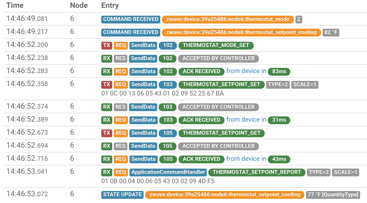

Updates to thermostat revert to previous value within milliseconds
I noticed some updates to the cool set point of my CT 100, were applied and then reverted back to the original value. This was especially the case for updates triggered through rules. I just updated to the latest snapshot (openHAB 2.4.0 Build #1364, followed instructions here:ZWave binding updates) in an attempt to remedy this, but now all updates are being immediately reverted to their previous values.
Any ideas would be greatly appreciated.
2018-09-16 13:21:53.206 [ome.event.ItemCommandEvent] - Item 'HVAC_CoolSetPoint' received command 78
2018-09-16 13:21:53.222 [nt.ItemStatePredictedEvent] - HVAC_CoolSetPoint predicted to become 78
2018-09-16 13:21:53.238 [vent.ItemStateChangedEvent] - HVAC_CoolSetPoint changed from 77 to 78
2018-09-16 13:21:53.250 [DEBUG] [ding.zwave.handler.ZWaveThingHandler] - NODE 6: Command received zwave:device:39a25486:node6:thermostat_setpoint_cooling --> 78 °C
2018-09-16 13:21:53.259 [DEBUG] [ter.ZWaveThermostatSetpointConverter] - NODE 6: Thermostat command received for 78 °C
2018-09-16 13:21:53.278 [DEBUG] [.ZWaveThermostatSetpointCommandClass] - NODE 6: Creating new message for command THERMOSTAT_SETPOINT_SET
2018-09-16 13:21:53.284 [DEBUG] [ng.zwave.internal.protocol.ZWaveNode] - NODE 6: SECURITY not supported
2018-09-16 13:21:53.291 [DEBUG] [ng.zwave.internal.protocol.ZWaveNode] - NODE 6: Command Class COMMAND_CLASS_THERMOSTAT_SETPOINT is NOT required to be secured
2018-09-16 13:21:53.304 [DEBUG] [ter.ZWaveThermostatSetpointConverter] - NODE 6: Sending Message: org.openhab.binding.zwave.internal.protocol.transaction.ZWaveCommandClassTransactionPayload@ed3a47
2018-09-16 13:21:53.309 [DEBUG] [.ZWaveThermostatSetpointCommandClass] - NODE 6: Creating new message for application command THERMOSTAT_SETPOINT_GET (Cooling)
2018-09-16 13:21:53.314 [DEBUG] [ng.zwave.internal.protocol.ZWaveNode] - NODE 6: SECURITY not supported
2018-09-16 13:21:53.318 [DEBUG] [ng.zwave.internal.protocol.ZWaveNode] - NODE 6: Command Class COMMAND_CLASS_THERMOSTAT_SETPOINT is NOT required to be secured
2018-09-16 13:21:53.322 [DEBUG] [nal.protocol.ZWaveTransactionManager] - NODE 6: Adding to device queue
2018-09-16 13:21:53.326 [DEBUG] [nal.protocol.ZWaveTransactionManager] - Transaction SendNextMessage 0 out at start. Holdoff false.
2018-09-16 13:21:53.334 [DEBUG] [wave.internal.protocol.SerialMessage] - Assembled message buffer = 01 0C 00 13 06 05 43 01 02 01 4E 25 DB 12
2018-09-16 13:21:53.340 [DEBUG] [ing.zwave.handler.ZWaveSerialHandler] - NODE 6: Sending REQUEST Message = 01 0C 00 13 06 05 43 01 02 01 4E 25 DB 12
2018-09-16 13:21:53.345 [DEBUG] [ing.zwave.handler.ZWaveSerialHandler] - Message SENT
2018-09-16 13:21:53.348 [DEBUG] [WaveSerialHandler$ZWaveReceiveThread] - Receive Message = 06
2018-09-16 13:21:53.349 [DEBUG] [nal.protocol.ZWaveTransactionManager] - Transaction SendNextMessage started: TID 475: [WAIT_RESPONSE] priority=Set, requiresResponse=true, callback: 219
2018-09-16 13:21:53.354 [DEBUG] [nal.protocol.ZWaveTransactionManager] - processReceiveMessage input 0<>128 : Message: class=null[0], type=ACK[2], dest=255, callback=0, payload=
2018-09-16 13:21:53.358 [DEBUG] [nal.protocol.ZWaveTransactionManager] - NODE 6: Adding to device queue
2018-09-16 13:21:53.359 [DEBUG] [nal.protocol.ZWaveTransactionManager] - Received msg (0): Message: class=null[0], type=ACK[2], dest=255, callback=0, payload=
2018-09-16 13:21:53.364 [DEBUG] [nal.protocol.ZWaveTransactionManager] - Transaction SendNextMessage 1 out at start. Holdoff false.
2018-09-16 13:21:53.364 [DEBUG] [nal.protocol.ZWaveTransactionManager] - lastTransaction TID 475: [WAIT_RESPONSE] priority=Set, requiresResponse=true, callback: 219
2018-09-16 13:21:53.370 [DEBUG] [nal.protocol.ZWaveTransactionManager] - Received msg: ACK
2018-09-16 13:21:53.373 [DEBUG] [nal.protocol.ZWaveTransactionManager] - ZWaveReceiveThread queue empty
2018-09-16 13:21:53.375 [DEBUG] [nal.protocol.ZWaveTransactionManager] - Transaction SendNextMessage 1 out at start. Holdoff false.
2018-09-16 13:21:53.370 [DEBUG] [ding.zwave.handler.ZWaveThingHandler] - NODE 6: Polling intialised at 1800 seconds - start in 1500 milliseconds.
2018-09-16 13:21:53.383 [DEBUG] [WaveSerialHandler$ZWaveReceiveThread] - Receive Message = 01 04 01 13 01 E8
2018-09-16 13:21:53.388 [DEBUG] [nal.protocol.ZWaveTransactionManager] - processReceiveMessage input 0<>128 : Message: class=SendData[19], type=Response[1], dest=255, callback=0, payload=01
2018-09-16 13:21:53.392 [DEBUG] [nal.protocol.ZWaveTransactionManager] - Received msg (0): Message: class=SendData[19], type=Response[1], dest=255, callback=0, payload=01
2018-09-16 13:21:53.397 [DEBUG] [nal.protocol.ZWaveTransactionManager] - lastTransaction TID 475: [WAIT_RESPONSE] priority=Set, requiresResponse=true, callback: 219
2018-09-16 13:21:53.401 [DEBUG] [WaveSerialHandler$ZWaveReceiveThread] - Receive Message = 01 07 00 13 DB 00 00 05 35
2018-09-16 13:21:53.401 [DEBUG] [nal.protocol.ZWaveTransactionManager] - Checking outstanding transactions: 1
2018-09-16 13:21:53.406 [DEBUG] [nal.protocol.ZWaveTransactionManager] - Last transaction: TID 475: [WAIT_RESPONSE] priority=Set, requiresResponse=true, callback: 219
2018-09-16 13:21:53.407 [DEBUG] [nal.protocol.ZWaveTransactionManager] - processReceiveMessage input 0<>128 : Message: class=SendData[19], type=Request[0], dest=0, callback=219, payload=DB 00 00 05
2018-09-16 13:21:53.418 [DEBUG] [ve.internal.protocol.ZWaveController] - Incoming Message: Message: class=SendData[19], type=Response[1], dest=255, callback=0, payload=01
2018-09-16 13:21:53.423 [DEBUG] [l.serialmessage.SendDataMessageClass] - NODE 6: sentData successfully placed on stack.
2018-09-16 13:21:53.427 [DEBUG] [nal.protocol.ZWaveTransactionManager] - TID 475: Advanced to WAIT_REQUEST
2018-09-16 13:21:53.430 [DEBUG] [nal.protocol.ZWaveTransactionManager] - NODE 6: TID 475: Transaction not completed
2018-09-16 13:21:53.433 [DEBUG] [nal.protocol.ZWaveTransactionManager] - Received msg (0): Message: class=SendData[19], type=Request[0], dest=0, callback=219, payload=DB 00 00 05
2018-09-16 13:21:53.435 [DEBUG] [nal.protocol.ZWaveTransactionManager] - lastTransaction TID 475: [WAIT_REQUEST] priority=Set, requiresResponse=true, callback: 219
2018-09-16 13:21:53.438 [DEBUG] [nal.protocol.ZWaveTransactionManager] - Checking outstanding transactions: 1
2018-09-16 13:21:53.440 [DEBUG] [nal.protocol.ZWaveTransactionManager] - Last transaction: TID 475: [WAIT_REQUEST] priority=Set, requiresResponse=true, callback: 219
2018-09-16 13:21:53.442 [DEBUG] [nal.protocol.ZWaveTransactionManager] - Checking TID 475: (Callback 219)
2018-09-16 13:21:53.446 [DEBUG] [.serialmessage.ZWaveCommandProcessor] - Callback match!
2018-09-16 13:21:53.449 [DEBUG] [nal.protocol.ZWaveTransactionManager] - Correlated to TID 475: callback 219
2018-09-16 13:21:53.453 [DEBUG] [ve.internal.protocol.ZWaveController] - Incoming Message: Message: class=SendData[19], type=Request[0], dest=0, callback=219, payload=DB 00 00 05
2018-09-16 13:21:53.456 [DEBUG] [l.serialmessage.SendDataMessageClass] - NODE 6: SendData Request. CallBack ID = 219, Status = Transmission complete and ACK received(0)
2018-09-16 13:21:53.461 [DEBUG] [ng.zwave.internal.protocol.ZWaveNode] - NODE 6: resetResendCount initComplete=true isDead=false
2018-09-16 13:21:53.463 [DEBUG] [e.internal.protocol.ZWaveTransaction] - TID 475: Transaction COMPLETED
2018-09-16 13:21:53.466 [DEBUG] [nal.protocol.ZWaveTransactionManager] - NODE 6: Response processed after 117ms
2018-09-16 13:21:53.468 [DEBUG] [nal.protocol.ZWaveTransactionManager] - NODE 6: TID 475: Transaction completed
2018-09-16 13:21:53.470 [DEBUG] [nal.protocol.ZWaveTransactionManager] - NODE 6: notifyTransactionResponse TID:475 DONE
2018-09-16 13:21:53.473 [DEBUG] [ding.zwave.handler.ZWaveThingHandler] - NODE 6: Got an event from Z-Wave network: ZWaveTransactionCompletedEvent
2018-09-16 13:21:53.475 [DEBUG] [nal.protocol.ZWaveTransactionManager] - ZWaveReceiveThread queue empty
2018-09-16 13:21:53.478 [DEBUG] [nal.protocol.ZWaveTransactionManager] - Transaction SendNextMessage 0 out at start. Holdoff false.
2018-09-16 13:21:53.482 [DEBUG] [wave.internal.protocol.SerialMessage] - Assembled message buffer = 01 0A 00 13 06 03 43 02 02 25 DC 59
2018-09-16 13:21:53.487 [DEBUG] [ing.zwave.handler.ZWaveSerialHandler] - NODE 6: Sending REQUEST Message = 01 0A 00 13 06 03 43 02 02 25 DC 59
2018-09-16 13:21:53.490 [DEBUG] [ing.zwave.handler.ZWaveSerialHandler] - Message SENT
2018-09-16 13:21:53.493 [DEBUG] [WaveSerialHandler$ZWaveReceiveThread] - Receive Message = 06
2018-09-16 13:21:53.494 [DEBUG] [nal.protocol.ZWaveTransactionManager] - Transaction SendNextMessage started: TID 476: [WAIT_RESPONSE] priority=Get, requiresResponse=true, callback: 220
2018-09-16 13:21:53.496 [DEBUG] [nal.protocol.ZWaveTransactionManager] - processReceiveMessage input 0<>128 : Message: class=null[0], type=ACK[2], dest=255, callback=0, payload=
2018-09-16 13:21:53.499 [DEBUG] [nal.protocol.ZWaveTransactionManager] - Received msg (0): Message: class=null[0], type=ACK[2], dest=255, callback=0, payload=
2018-09-16 13:21:53.501 [DEBUG] [WaveSerialHandler$ZWaveReceiveThread] - Receive Message = 01 04 01 13 01 E8
2018-09-16 13:21:53.503 [DEBUG] [nal.protocol.ZWaveTransactionManager] - lastTransaction TID 476: [WAIT_RESPONSE] priority=Get, requiresResponse=true, callback: 220
2018-09-16 13:21:53.505 [DEBUG] [nal.protocol.ZWaveTransactionManager] - processReceiveMessage input 0<>128 : Message: class=SendData[19], type=Response[1], dest=255, callback=0, payload=01
2018-09-16 13:21:53.507 [DEBUG] [nal.protocol.ZWaveTransactionManager] - Received msg: ACK
2018-09-16 13:21:53.511 [DEBUG] [nal.protocol.ZWaveTransactionManager] - Received msg (0): Message: class=SendData[19], type=Response[1], dest=255, callback=0, payload=01
2018-09-16 13:21:53.516 [DEBUG] [nal.protocol.ZWaveTransactionManager] - lastTransaction TID 476: [WAIT_RESPONSE] priority=Get, requiresResponse=true, callback: 220
2018-09-16 13:21:53.519 [DEBUG] [nal.protocol.ZWaveTransactionManager] - Checking outstanding transactions: 1
2018-09-16 13:21:53.523 [DEBUG] [nal.protocol.ZWaveTransactionManager] - Last transaction: TID 476: [WAIT_RESPONSE] priority=Get, requiresResponse=true, callback: 220
2018-09-16 13:21:53.527 [DEBUG] [ve.internal.protocol.ZWaveController] - Incoming Message: Message: class=SendData[19], type=Response[1], dest=255, callback=0, payload=01
2018-09-16 13:21:53.531 [DEBUG] [l.serialmessage.SendDataMessageClass] - NODE 6: sentData successfully placed on stack.
2018-09-16 13:21:53.535 [DEBUG] [nal.protocol.ZWaveTransactionManager] - TID 476: Advanced to WAIT_REQUEST
2018-09-16 13:21:53.538 [DEBUG] [nal.protocol.ZWaveTransactionManager] - NODE 6: TID 476: Transaction not completed
2018-09-16 13:21:53.541 [DEBUG] [nal.protocol.ZWaveTransactionManager] - ZWaveReceiveThread queue empty
2018-09-16 13:21:53.545 [DEBUG] [nal.protocol.ZWaveTransactionManager] - Transaction SendNextMessage 1 out at start. Holdoff false.
2018-09-16 13:21:53.545 [DEBUG] [WaveSerialHandler$ZWaveReceiveThread] - Receive Message = 01 07 00 13 DC 00 00 05 32
2018-09-16 13:21:53.553 [DEBUG] [nal.protocol.ZWaveTransactionManager] - processReceiveMessage input 0<>128 : Message: class=SendData[19], type=Request[0], dest=0, callback=220, payload=DC 00 00 05
2018-09-16 13:21:53.556 [DEBUG] [nal.protocol.ZWaveTransactionManager] - Received msg (0): Message: class=SendData[19], type=Request[0], dest=0, callback=220, payload=DC 00 00 05
2018-09-16 13:21:53.559 [DEBUG] [nal.protocol.ZWaveTransactionManager] - lastTransaction TID 476: [WAIT_REQUEST] priority=Get, requiresResponse=true, callback: 220
2018-09-16 13:21:53.561 [DEBUG] [nal.protocol.ZWaveTransactionManager] - Checking outstanding transactions: 1
2018-09-16 13:21:53.564 [DEBUG] [nal.protocol.ZWaveTransactionManager] - Last transaction: TID 476: [WAIT_REQUEST] priority=Get, requiresResponse=true, callback: 220
2018-09-16 13:21:53.566 [DEBUG] [nal.protocol.ZWaveTransactionManager] - Checking TID 476: (Callback 220)
2018-09-16 13:21:53.569 [DEBUG] [.serialmessage.ZWaveCommandProcessor] - Callback match!
2018-09-16 13:21:53.571 [DEBUG] [nal.protocol.ZWaveTransactionManager] - Correlated to TID 476: callback 220
2018-09-16 13:21:53.576 [DEBUG] [ve.internal.protocol.ZWaveController] - Incoming Message: Message: class=SendData[19], type=Request[0], dest=0, callback=220, payload=DC 00 00 05
2018-09-16 13:21:53.578 [DEBUG] [l.serialmessage.SendDataMessageClass] - NODE 6: SendData Request. CallBack ID = 220, Status = Transmission complete and ACK received(0)
2018-09-16 13:21:53.581 [DEBUG] [ng.zwave.internal.protocol.ZWaveNode] - NODE 6: resetResendCount initComplete=true isDead=false
2018-09-16 13:21:53.584 [DEBUG] [nal.protocol.ZWaveTransactionManager] - TID 476: Advanced to WAIT_DATA
2018-09-16 13:21:53.587 [DEBUG] [nal.protocol.ZWaveTransactionManager] - NODE 6: TID 476: Transaction not completed
2018-09-16 13:21:53.590 [DEBUG] [nal.protocol.ZWaveTransactionManager] - ZWaveReceiveThread queue empty
2018-09-16 13:21:53.594 [DEBUG] [nal.protocol.ZWaveTransactionManager] - Transaction SendNextMessage 1 out at start. Holdoff false.
2018-09-16 13:21:53.795 [DEBUG] [WaveSerialHandler$ZWaveReceiveThread] - Receive Message = 01 0B 00 04 00 06 05 43 03 02 09 4D F5
2018-09-16 13:21:53.804 [DEBUG] [nal.protocol.ZWaveTransactionManager] - processReceiveMessage input 0<>128 : Message: class=ApplicationCommandHandler[4], type=Request[0], dest=6, callback=0, payload=00 06 05 43 03 02 09 4D
2018-09-16 13:21:53.810 [DEBUG] [nal.protocol.ZWaveTransactionManager] - Received msg (0): Message: class=ApplicationCommandHandler[4], type=Request[0], dest=6, callback=0, payload=00 06 05 43 03 02 09 4D
2018-09-16 13:21:53.813 [DEBUG] [nal.protocol.ZWaveTransactionManager] - lastTransaction null
2018-09-16 13:21:53.820 [DEBUG] [nal.protocol.ZWaveTransactionManager] - NODE 6: Application Command Request (ALIVE:DONE)
2018-09-16 13:21:53.824 [DEBUG] [ng.zwave.internal.protocol.ZWaveNode] - NODE 6: resetResendCount initComplete=true isDead=false
2018-09-16 13:21:53.829 [DEBUG] [ng.zwave.internal.protocol.ZWaveNode] - NODE 6: Incoming command class COMMAND_CLASS_THERMOSTAT_SETPOINT, endpoint 0
2018-09-16 13:21:53.832 [DEBUG] [ng.zwave.internal.protocol.ZWaveNode] - NODE 6: SECURITY not supported
2018-09-16 13:21:53.837 [DEBUG] [tocol.commandclass.ZWaveCommandClass] - NODE 6: Received COMMAND_CLASS_THERMOSTAT_SETPOINT V1 THERMOSTAT_SETPOINT_REPORT
2018-09-16 13:21:53.841 [DEBUG] [.ZWaveThermostatSetpointCommandClass] - NODE 6: Thermostat Setpoint report Scale = 1
2018-09-16 13:21:53.847 [DEBUG] [.ZWaveThermostatSetpointCommandClass] - NODE 6: Thermostat Setpoint Value = 77
2018-09-16 13:21:53.850 [DEBUG] [.ZWaveThermostatSetpointCommandClass] - NODE 6: Thermostat Setpoint Report, Type Cooling (2), value = 77
2018-09-16 13:21:53.856 [DEBUG] [ding.zwave.handler.ZWaveThingHandler] - NODE 6: Got an event from Z-Wave network: ZWaveThermostatSetpointValueEvent
2018-09-16 13:21:53.859 [DEBUG] [ding.zwave.handler.ZWaveThingHandler] - NODE 6: Got a value event from Z-Wave network, endpoint = 0, command class = COMMAND_CLASS_THERMOSTAT_SETPOINT, value = 77
2018-09-16 13:21:53.865 [DEBUG] [ding.zwave.handler.ZWaveThingHandler] - NODE 6: Updating channel state zwave:device:39a25486:node6:thermostat_setpoint_cooling to 77 °F [QuantityType]
2018-09-16 13:21:53.873 [DEBUG] [nal.protocol.ZWaveTransactionManager] - NODE 6: Commands processed 1.
2018-09-16 13:21:53.883 [vent.ItemStateChangedEvent] - HVAC_CoolSetPoint changed from 78 to 77s

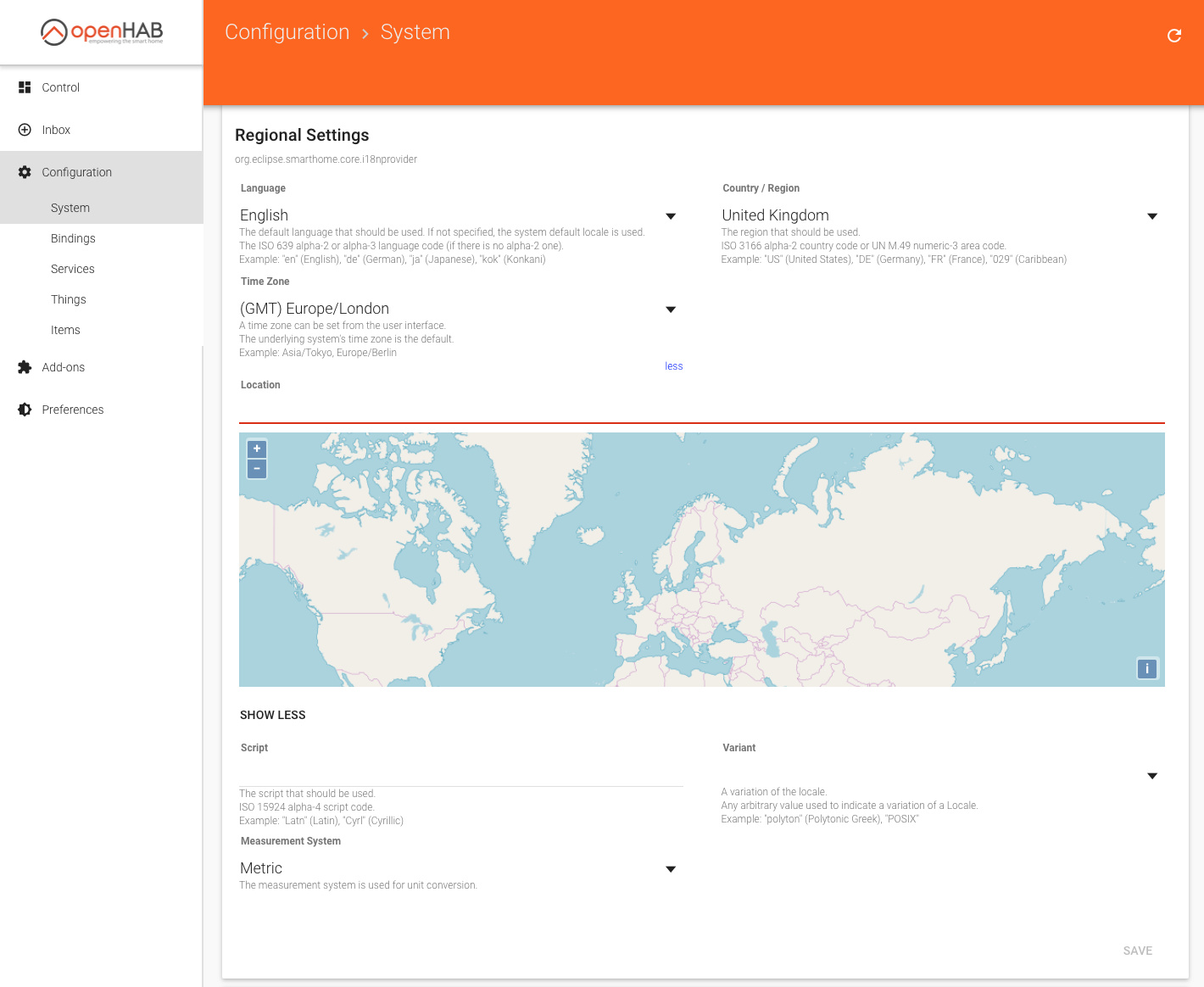

Probably you missed the part about setting the locale? Either that, or you like your heating REALLY hot as you’re setting it to 78 deg C.
Thanks for the quick reply! I managed to get it to work by adding the unit in the Item file.
You can set set the default in the system settings -:
The binding will now send through the units to the device, so this needs to be set correctly…
Seems I was celebrating to early. There were at least two different problems. Setting the locale fixed issue one: changing the value manually through habpanel etc. However issue two changing the value from rules still persists.

There’s nothing wrong with what the binding is sending -:
Does the thermostat actually change temperature?
When I trigger the update this way (through a rule) my dummy in habpanel blinks the new value, then goes back, the thermostat lcd doesn’t change at all. When changed out off habpanel, the update goes through and is reflected on the thermostat. When changed on the thermostat the new value is correctly updated in openhab.
In that case you need to work out what the difference is - check the logs for both and there must be a difference.
The difference seems to be that the rule sends a command to change the opmode to cool and sets a cool setpoint at basically the same time. While changing the value through habpanel only updates the set point. I commented the part with the opmode change out off the rule and now the setpoint is being updated as expected.
No idea why it doesn’t like both changes at once (especially as it has worked intermittent in the past), but I should be able to find a way around that now.
Thanks for pointing me in the right direction again!

I can change the fan mode and the heating mode but I can’t change any setpoints. I am not sure what the difference is. I have checked through habmin to make sure that all the items are associated correctly. I don’t see any errors showing in habmin for the device.
I have set my default units in PaperUI to Imperial. I am not sure what else I can try, @chris any guidance on what else to check would be greatly appreciated.

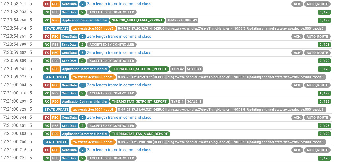

I also put the Zwave binding in debug mode and captured the log, I viewed in the log viewer but not really sure what I am looking at.
17:20:53.911	5
TX REQ SendData 2 Zero length frame in command class  ACK AUTO_ROUTE
17:20:53.933	5
RX RES SendData 2 ACCEPTED BY CONTROLLER 0 /128
17:20:54.268	5
RX REQ ApplicationCommandHandler SENSOR_MULTI_LEVEL_REPORT TEMPERATURE=42 0 /128
17:20:54.314	5
STATE UPDATE zwave:device:0001:node5 8-09-25 17:20:54.314 [DEBUG] [ding.zwave.handler.ZWaveThingHandler] - NODE 5: Updating channel state zwave:device:0001:node5:
17:20:54.351	5
17:20:54.399	5
17:20:59.502	5
TX REQ SendData 3 Zero length frame in command class  ACK AUTO_ROUTE
17:20:59.509	5
RX RES SendData 3 ACCEPTED BY CONTROLLER 0 /128
17:20:59.941	5
RX REQ ApplicationCommandHandler THERMOSTAT_SETPOINT_REPORT TYPE=2 SCALE=1 0 /128
17:20:59.972	5
STATE UPDATE zwave:device:0001:node5 8-09-25 17:20:59.972 [DEBUG] [ding.zwave.handler.ZWaveThingHandler] - NODE 5: Updating channel state zwave:device:0001:node5:
17:21:00.004	5
17:21:00.016	5
RX RES SendData 3 ACCEPTED BY CONTROLLER 1 /128
17:21:00.299	5
RX REQ ApplicationCommandHandler THERMOSTAT_SETPOINT_REPORT TYPE=1 SCALE=1 0 /128
17:21:00.323	5
STATE UPDATE zwave:device:0001:node5 8-09-25 17:21:00.323 [DEBUG] [ding.zwave.handler.ZWaveThingHandler] - NODE 5: Updating channel state zwave:device:0001:node5:
17:21:00.344	5
17:21:00.351	5
17:21:00.688	5
RX REQ ApplicationCommandHandler THERMOSTAT_FAN_MODE_REPORT 0 /128
17:21:00.700	5
STATE UPDATE zwave:device:0001:node5 8-09-25 17:21:00.700 [DEBUG] [ding.zwave.handler.ZWaveThingHandler] - NODE 5: Updating channel state zwave:device:0001:node5:
17:21:00.715	5
17:21:00.721	5
I don’t know if the zero length frame in command class messages are a problem or not.

My guess is that problem is the commands are not formatted correctly…
Normally, there is a degree symbol in the command - like you see in the state update below -:
However, in your commands, it’s different -:
The binding is not getting the unit from this, so it is using degC, and this is likely then being rejected by the thermostat.
Maybe the first one looked strange because I had copy pasted into a file on my Mac, not sure but I can tell you that I certainly didn’t make it up. - That’s what I see in my logs. I don’t think it was in DEBUG mode or each line would have had [DEBUG] in front like the current one does. I didn’t remove the tags. - The file I have linked to is just the openhab.log as it appears at this time in my /var/log/openhab/ directory.
OK, let me see if I can put a degree symbol in there. I do have my default units set to imperial.
