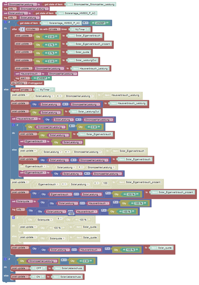

Then i performed the recommended way to update my blockly rules: Rules Blockly | openHAB
But by re-saving some of the rules i am getting log errors:
2023-11-08 11:30:30.847 [ERROR] [automation.internal.RuleRegistryImpl] - The rule '4d741a5a40' is not updated, the new version is invalid
java.lang.IllegalArgumentException: The rule '4d741a5a40' has incorrect configurations
