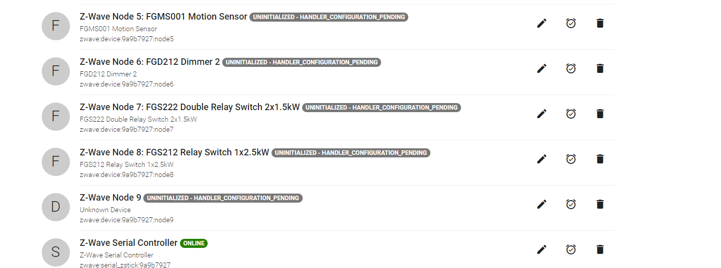

I Upgraded to 2.4 via apt and now all Z-Wave Node have status: UNINITIALIZED - HANDLER_CONFIGURATION_PENDING -
Cleared cache,
restarted OpenHAB a few times, no luck
I see my “Z-Wave Serial Controller” is still online

Maybe this has something to do with it!!???
