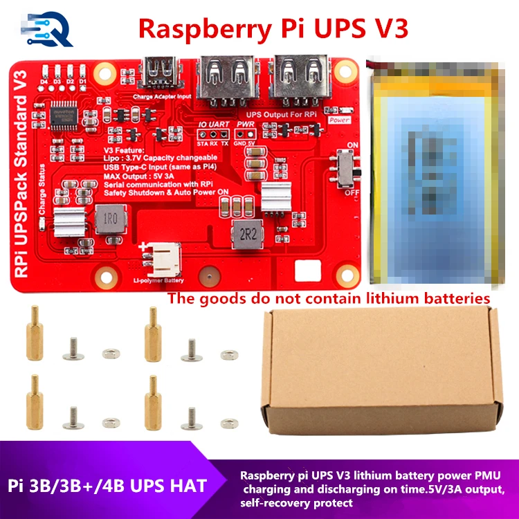

I have Neue version RPI UPS Pack nicht enthalten lithium batterry, neue Expansion Board Netzteil mit Schalter für Raspberry 4B/3B +/3B - AliExpress 7

Yes I can talk to mcu I updated the firmware and it sends a message over uart.
communication heartbeat packets, whether there is an external power failure, percentage of battery capacity, outgoing voltage value.
or
STA Single Bus Interface: the UPS motherboard sends a pulse message (Halt signal) to the Raspberry Pie motherboard before the battery runs out, allowing the Raspberry Pie to safely perform a software shutdown. Once the Raspberry Pie is safely shut down, the Raspberry Pie’s 5V mains power supply is cut off again. (Both the USB-A and the 2P socket are programmed to do so). When the external power is restored, the UPS motherboard will automatically enter the charging process, and when the battery charge reaches a certain capacity, it will automatically restore power to the Raspberry Pie.
I have it connected to a 6000mah batt that I already had. The connector was different so I just soldered the batt to the board. It lasts many hours so its hard to fully integrate as it takes a long time to test.
I have already ordered the: 1) board
The awg22 cables Dupont-Kabel 20cm weicher Silikon draht 24awg 1-poliger Überbrückung draht von Buchse zu Buchse für RC-Drohne DIY elektronisches Kit Steck brett 40 teile/los - AliExpress 26 and the battery in amazon Amazon.es
When all the materials arrive 15 or 20 days, I will go to work and report to the forum
