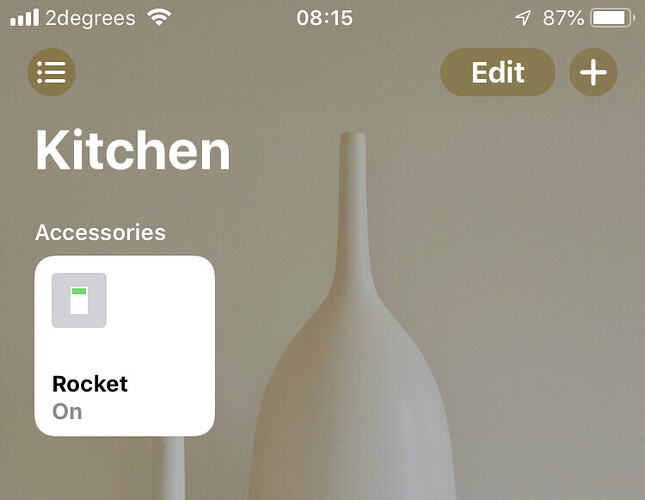

Explosed to Homekit this item looks liek the following - something that is possible in OpenHAB I might say
But what is not currently possible is an alarm system, so this was one of the first reasons why I wanted Home Assistant to be my Homekit controller…it also just seems a little more mature/stable. I also have issues with the OpenHAB addon when my system restarts (I am docker based).
