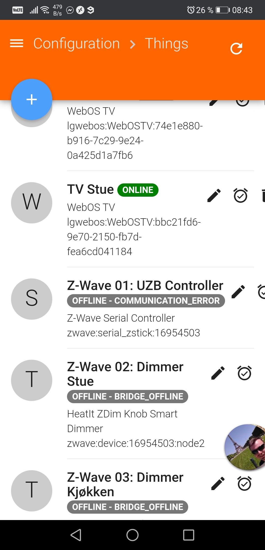

UZB Controller keeps going offline
Hello, my UZB keeps going offline
I can se from the console zwave is restarting often. I think i have tried everything in te community forum. Anyone have any pointers? I removed restdocs and the http binding. But still it goes offline util I restart openhab. Oh versiin 2.5.8

This is how it looks now, should I just try deleting the file itself?

Thanks for posting that. I usually try t o compare with the Breaking Changes listed in the 2.5.0 Release Notes. Has wol1 moved to Legacy Bindings? I do not know but it may be worth checking.
Please do not do that.
I an currently running that controller in OH3 on my test system with no issues.
Should i just move to O3 M1? I have no issues doing that. Somewhat time consuming but no stress. (fresh install with item files copied from oh2)
I would not do that. OH3 is just for testing My personal suggestion on that would be to wait a year for further development and stability fixes. I know others here have a different opinion.
Comparing with the Release Notes, you may want to look at these. Not sure it would cause your issues though.
LGWebOS
The binding parameter 'localIP' has been removed. The binding now uses system defaults for network communication. The thing type parameter 'deviceId' is no longer a parameter, but a property. Parameters 'host' and 'key' have been added.
Somfytahoma Binding
The following channels have been renamed: 'cyclic_button_state' to 'cyclic_button', 'battery_status_state' to 'battery_status' and 'lighting_led_pod_mod_state' to 'lighting_led_pod_mode'
I assume you have restarted OH. Some have had to do that up to 3 times after upgrade.
Other than that, try collecting Z-Wave debug logs as mentioned in the documentation.

I would suggest to check the logs as that should help understand the problem. The binding docs describe what to do.
20:55:37.979 [DEBUG] [rnal.protocol.ZWaveTransactionManager] - Transaction SendNextMessage started: TID 919: [WAIT_RESPONSE] priority=Config, requiresResponse=true, callback: 248
20:55:39.979 [DEBUG] [nsactionManager$ZWaveTransactionTimer] - NODE 28: TID 919: Timeout at state WAIT_RESPONSE. 3 retries remaining.
20:55:39.980 [DEBUG] [nsactionManager$ZWaveTransactionTimer] - Aborting Transaction!
20:55:39.990 [DEBUG] [ve.internal.protocol.ZWaveTransaction] - TID 919: Transaction ABORTED
20:55:39.991 [DEBUG] [zwave.internal.protocol.SerialMessage] - Assembled message buffer = 01 03 00 16 EA
20:55:39.991 [DEBUG] [ding.zwave.handler.ZWaveSerialHandler] - NODE 255: Sending REQUEST Message = 01 03 00 16 EA
20:55:39.992 [DEBUG] [ding.zwave.handler.ZWaveSerialHandler] - Message SENT
20:55:39.992 [DEBUG] [rnal.protocol.ZWaveTransactionManager] - Transaction SendNextMessage 1 out at start. Holdoff false.
20:55:51.990 [DEBUG] [nsactionManager$ZWaveTransactionTimer] - NODE 28: TID 919: Timeout at state ABORTED. 3 retries remaining.
20:55:51.992 [DEBUG] [nsactionManager$ZWaveTransactionTimer] - TID 919: Transaction is current transaction, so clearing!!!
20:55:51.993 [DEBUG] [ve.internal.protocol.ZWaveTransaction] - TID 919: Transaction CANCELLED
20:55:51.993 [DEBUG] [nding.zwave.handler.ZWaveThingHandler] - NODE 28: Got an event from Z-Wave network: ZWaveTransactionCompletedEvent
20:55:51.994 [DEBUG] [rnal.protocol.ZWaveTransactionManager] - NODE 28: notifyTransactionResponse TID:919 CANCELLED
20:55:51.995 [DEBUG] [rnal.protocol.ZWaveTransactionManager] - Transaction SendNextMessage 0 out at start. Holdoff false.
20:55:51.995 [DEBUG] [rnal.protocol.ZWaveTransactionManager] - TID 919: Transaction event listener: DONE: CANCELLED β†’
20:55:51.996 [DEBUG] [ialization.ZWaveNodeInitStageAdvancer] - NODE 28: Node Init response (0) org.openhab.binding.zwave.internal.protocol.ZWaveTransactionResponse@60dedad6
20:55:51.996 [DEBUG] [ialization.ZWaveNodeInitStageAdvancer] - NODE 28: Node Init transaction completed with response COMPLETE
20:55:51.997 [DEBUG] [ialization.ZWaveNodeInitStageAdvancer] - NODE 28: Node advancer: VERSION - checking COMMAND_CLASS_ASSOCIATION, version is 0
20:55:51.998 [DEBUG] [ialization.ZWaveNodeInitStageAdvancer] - NODE 28: Node advancer: VERSION - queued COMMAND_CLASS_ASSOCIATION
20:55:51.998 [DEBUG] [commandclass.ZWaveVersionCommandClass] - NODE 28: Creating new message for application command VERSION_COMMAND_CLASS_GET command class COMMAND_CLASS_ASSOCIATION
20:55:51.999 [DEBUG] [ialization.ZWaveNodeInitStageAdvancer] - NODE 28: ZWaveCommandClassTransactionPayload - send to node
20:55:51.999 [DEBUG] [ing.zwave.internal.protocol.ZWaveNode] - NODE 28: SECURITY NOT required on COMMAND_CLASS_VERSION
20:55:52.000 [DEBUG] [ing.zwave.internal.protocol.ZWaveNode] - NODE 28: Command Class COMMAND_CLASS_VERSION is NOT required to be secured
20:55:52.001 [DEBUG] [rnal.protocol.ZWaveTransactionManager] - NODE 28: sendTransaction org.openhab.binding.zwave.internal.protocol.transaction.ZWaveCommandClassTransactionPayload@7cd03cf5
20:55:52.001 [DEBUG] [rnal.protocol.ZWaveTransactionManager] - NODE 28: Adding to device queue
20:55:52.002 [DEBUG] [rnal.protocol.ZWaveTransactionManager] - NODE 28: Added 920 to queue - size 3
20:55:52.002 [DEBUG] [rnal.protocol.ZWaveTransactionManager] - Transaction SendNextMessage 0 out at start. Holdoff false.
20:55:52.003 [DEBUG] [zwave.internal.protocol.SerialMessage] - Assembled message buffer = 01 0A 00 13 1C 03 86 13 85 25 F9 35
20:55:52.004 [DEBUG] [ding.zwave.handler.ZWaveSerialHandler] - NODE 28: Sending REQUEST Message = 01 0A 00 13 1C 03 86 13 85 25 F9 35
20:55:52.208 [WARN ] [ding.zwave.handler.ZWaveSerialHandler] - Got I/O exception Input/output error in writeArray during sending. exiting thread.
20:55:52.210 [INFO ] [ome.event.ThingStatusInfoChangedEvent] - Thing β€˜zwave:serial_zstick:16954503’ changed from ONLINE to OFFLINE (COMMUNICATION_ERROR): Controller is offline
20:55:52.210 [DEBUG] [nding.zwave.handler.ZWaveThingHandler] - NODE 8: Controller status changed to OFFLINE.
20:55:52.211 [DEBUG] [nding.zwave.handler.ZWaveThingHandler] - NODE 5: Controller status changed to OFFLINE.
20:55:52.211 [DEBUG] [nding.zwave.handler.ZWaveThingHandler] - NODE 6: Controller status changed to OFFLINE.
20:55:52.211 [DEBUG] [nding.zwave.handler.ZWaveThingHandler] - NODE 7: Controller status changed to OFFLINE.
20:55:52.211 [DEBUG] [.zwave.handler.ZWaveControllerHandler] - Stopping ZWave network
20:55:52.210 [DEBUG] [nding.zwave.handler.ZWaveThingHandler] - NODE 9: Controller status changed to OFFLINE.
20:55:52.214 [DEBUG] [ave.internal.protocol.ZWaveController] - Shutting down ZWave controller
20:55:52.214 [DEBUG] [nding.zwave.handler.ZWaveThingHandler] - NODE 7: Controller is not online.
20:55:52.214 [DEBUG] [nding.zwave.handler.ZWaveThingHandler] - NODE 6: Controller is not online.
20:55:52.213 [DEBUG] [nding.zwave.handler.ZWaveThingHandler] - NODE 5: Controller is not online.
20:55:52.212 [DEBUG] [nding.zwave.handler.ZWaveThingHandler] - NODE 8: Controller is not online.
20:55:52.212 [INFO ] [ome.event.ThingStatusInfoChangedEvent] - Thing β€˜zwave:device:16954503:node8’ changed from ONLINE to OFFLINE (BRIDGE_OFFLINE): Controller is offline
20:55:52.217 [DEBUG] [nding.zwave.handler.ZWaveThingHandler] - NODE 3: Controller status changed to OFFLINE.
20:55:52.217 [DEBUG] [nding.zwave.handler.ZWaveThingHandler] - NODE 4: Controller status changed to OFFLINE.
20:55:52.216 [DEBUG] [nding.zwave.handler.ZWaveThingHandler] - NODE 14: Controller status changed to OFFLINE.
20:55:52.216 [DEBUG] [nding.zwave.handler.ZWaveThingHandler] - NODE 13: Controller status changed to OFFLINE.
20:55:52.220 [DEBUG] [nding.zwave.handler.ZWaveThingHandler] - NODE 14: Controller is not online.
20:55:52.216 [DEBUG] [rnal.protocol.ZWaveTransactionManager] - Shutting down transaction manager
20:55:52.215 [DEBUG] [nding.zwave.handler.ZWaveThingHandler] - NODE 9: Controller is not online.
20:55:52.221 [DEBUG] [rnal.protocol.ZWaveTransactionManager] - Exiting ZWave Receive Thread
20:55:52.220 [DEBUG] [nding.zwave.handler.ZWaveThingHandler] - NODE 2: Controller status changed to OFFLINE.
20:55:52.220 [DEBUG] [nding.zwave.handler.ZWaveThingHandler] - NODE 13: Controller is not online.
20:55:52.219 [DEBUG] [nding.zwave.handler.ZWaveThingHandler] - NODE 4: Controller is not online.
20:55:52.218 [DEBUG] [nding.zwave.handler.ZWaveThingHandler] - NODE 3: Controller is not online.
20:55:52.218 [INFO ] [ome.event.ThingStatusInfoChangedEvent] - Thing β€˜zwave:device:16954503:node5’ changed from ONLINE to OFFLINE (BRIDGE_OFFLINE): Controller is offline
20:55:52.224 [DEBUG] [nding.zwave.handler.ZWaveThingHandler] - NODE 12: Controller status changed to OFFLINE.
20:55:52.223 [DEBUG] [nding.zwave.handler.ZWaveThingHandler] - NODE 10: Controller status changed to OFFLINE.
20:55:52.223 [DEBUG] [nding.zwave.handler.ZWaveThingHandler] - NODE 15: Controller status changed to OFFLINE.
20:55:52.223 [DEBUG] [nding.zwave.handler.ZWaveThingHandler] - NODE 2: Controller is not online.
20:55:52.222 [DEBUG] [nding.zwave.handler.ZWaveThingHandler] - NODE 16: Controller status changed to OFFLINE.
20:55:52.226 [DEBUG] [nding.zwave.handler.ZWaveThingHandler] - NODE 11: Controller status changed to OFFLINE.
20:55:52.226 [DEBUG] [nding.zwave.handler.ZWaveThingHandler] - NODE 15: Controller is not online.
20:55:52.226 [DEBUG] [nding.zwave.handler.ZWaveThingHandler] - NODE 10: Controller is not online.
20:55:52.225 [DEBUG] [nding.zwave.handler.ZWaveThingHandler] - NODE 12: Controller is not online.
20:55:52.224 [INFO ] [ome.event.ThingStatusInfoChangedEvent] - Thing β€˜zwave:device:16954503:node6’ changed from ONLINE to OFFLINE (BRIDGE_OFFLINE): Controller is offline
20:55:52.229 [DEBUG] [nding.zwave.handler.ZWaveThingHandler] - NODE 19: Controller status changed to OFFLINE.
20:55:52.228 [DEBUG] [nding.zwave.handler.ZWaveThingHandler] - NODE 17: Controller status changed to OFFLINE.
20:55:52.228 [DEBUG] [nding.zwave.handler.ZWaveThingHandler] - NODE 18: Controller status changed to OFFLINE.
20:55:52.227 [DEBUG] [nding.zwave.handler.ZWaveThingHandler] - NODE 11: Controller is not online.
20:55:52.227 [DEBUG] [nding.zwave.handler.ZWaveThingHandler] - NODE 16: Controller is not online.
20:55:52.271 [DEBUG] [nding.zwave.handler.ZWaveThingHandler] - NODE 24: Controller status changed to OFFLINE.
20:55:52.271 [DEBUG] [nding.zwave.handler.ZWaveThingHandler] - NODE 18: Controller is not online.
20:55:52.271 [DEBUG] [nding.zwave.handler.ZWaveThingHandler] - NODE 17: Controller is not online.
20:55:52.270 [DEBUG] [nding.zwave.handler.ZWaveThingHandler] - NODE 19: Controller is not online.
20:55:52.270 [INFO ] [ome.event.ThingStatusInfoChangedEvent] - Thing β€˜zwave:device:16954503:node7’ changed from ONLINE to OFFLINE (BRIDGE_OFFLINE): Controller is offline
20:55:52.272 [DEBUG] [nding.zwave.handler.ZWaveThingHandler] - NODE 20: Controller status changed to OFFLINE.
20:55:52.272 [DEBUG] [nding.zwave.handler.ZWaveThingHandler] - NODE 21: Controller status changed to OFFLINE.
20:55:52.271 [DEBUG] [nding.zwave.handler.ZWaveThingHandler] - NODE 26: Controller status changed to OFFLINE.
20:55:52.271 [DEBUG] [nding.zwave.handler.ZWaveThingHandler] - NODE 24: Controller is not online.
20:55:52.271 [DEBUG] [nding.zwave.handler.ZWaveThingHandler] - NODE 27: Controller status changed to OFFLINE.
20:55:52.273 [DEBUG] [nding.zwave.handler.ZWaveThingHandler] - NODE 23: Controller status changed to OFFLINE.
20:55:52.272 [DEBUG] [nding.zwave.handler.ZWaveThingHandler] - NODE 26: Controller is not online.
20:55:52.272 [DEBUG] [nding.zwave.handler.ZWaveThingHandler] - NODE 21: Controller is not online.
20:55:52.272 [DEBUG] [nding.zwave.handler.ZWaveThingHandler] - NODE 20: Controller is not online.
20:55:52.272 [INFO ] [ome.event.ThingStatusInfoChangedEvent] - Thing β€˜zwave:device:16954503:node9’ changed from ONLINE to OFFLINE (BRIDGE_OFFLINE): Controller is offline
20:55:52.273 [DEBUG] [nding.zwave.handler.ZWaveThingHandler] - NODE 35: Controller status changed to OFFLINE.
20:55:52.273 [DEBUG] [nding.zwave.handler.ZWaveThingHandler] - NODE 28: Controller status changed to OFFLINE.
20:55:52.273 [DEBUG] [nding.zwave.handler.ZWaveThingHandler] - NODE 29: Controller status changed to OFFLINE.
