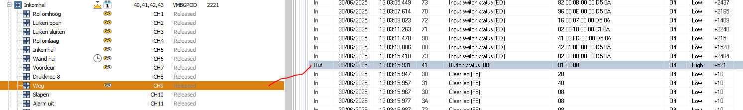

I have updated from 3.2 to 4.3.15.

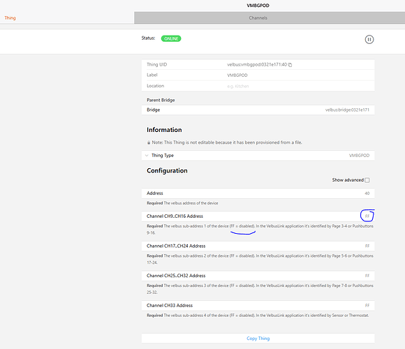

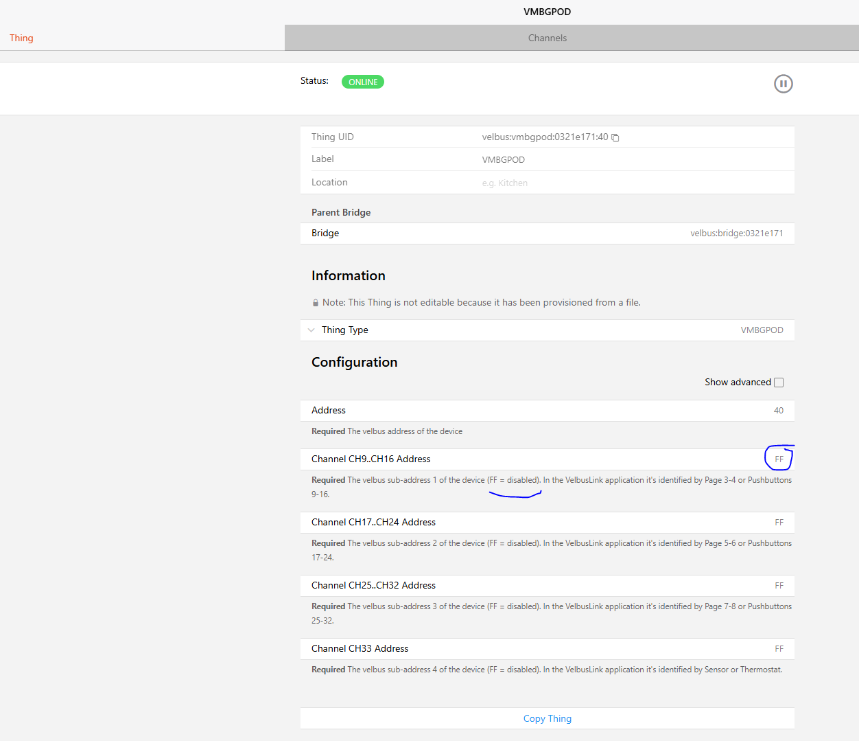

Now my Velbus is working except the VMBGPOD channels in the rules are doing notting
I see that they have FF witch means disabled… How to enable them?

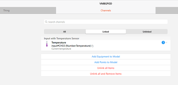

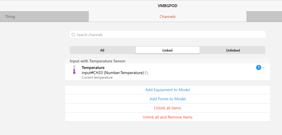

only linked channel is the 33 temperature

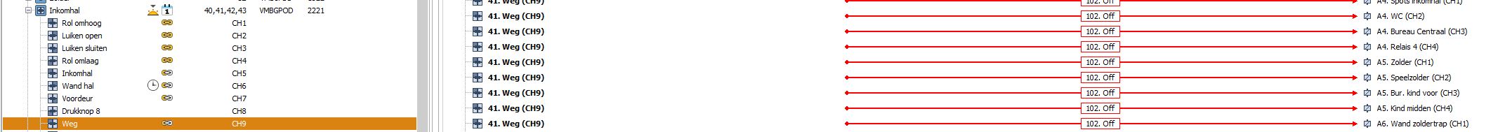

Switch Weg "Weg" <motion> {channel="velbus:vmbgpod:0321e171:40:CH9", autoupdate="false"}
rule "Alarm modus - Weg - dummy"
Channel 'velbus:vmbgpod:0321e171:40:input#CH9' triggered PRESSED
or Item Weg received command ON
logInfo("Alarm", "Weg-modus geactiveerd test")
Bridge velbus:bridge:0321e171 [ port="COM4", timeUpdateInterval="360", reconnectionInterval="15"] {
Thing vmbmeteo 08 [ address="08" ]
Thing vmbmeteo 09 [ address="09" ]
Thing vmbgpod 40 [ address="40" ]
Thing vmbgpod 44 [ address="44" ]
Thing vmbgpod 48 [ address="48" ]
Thing vmbgpod 4C [ address="4C" ]
Thing vmbpiro 70 [ address="70" ]
Thing vmbpiro 71 [ address="71" ]
Thing vmbpiro 72 [ address="72" ]
Thing vmbpiro 73 [ address="73" ]
Thing vmb2ble B1 [ address="B1" ]
Thing vmb2ble B2 [ address="B2" ]

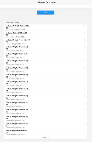

I did a manual scan, but the vmbgpod 40, 44, 48, 4C are not in the list…

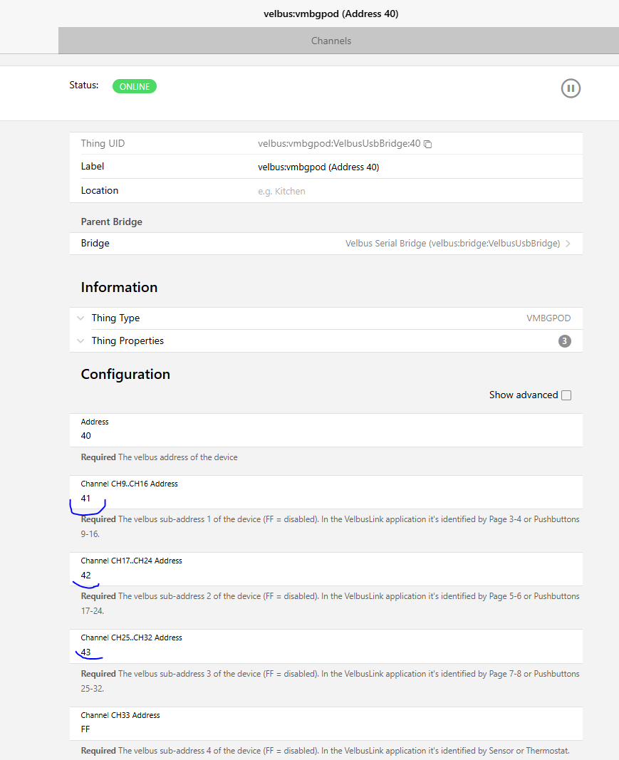

Can you confirm that buttons 1 to 8 work with the way you have it added at the moment?
Due to things like this, I tend to add modules in the main UI so that the Thing is configured perfectly.
After that, I tend to use text files for Items, purely as I find it easier to bulk edit or find silly typos.
You are correct, button 1 to 8 is working.
I like more the thing configuration in the files. To bad this not working.
I will try to make it work with the UI.

Excellent news.
I would suggest disabling your Text Thing and add the OLED in the UI, purely to prove it works.
Then you can recreate the Thing configuration in Text.
I suspect it is how the extra base addresses are added in the Text file.
Thanks for the help
Now is see addresses different from FF
