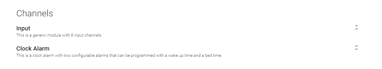

but the only channels i see are the once i see above Input and Clock alarm

Hi
Can you provide a screen shot of what you can see please.
For example, this is what I have for a VMB7IN.

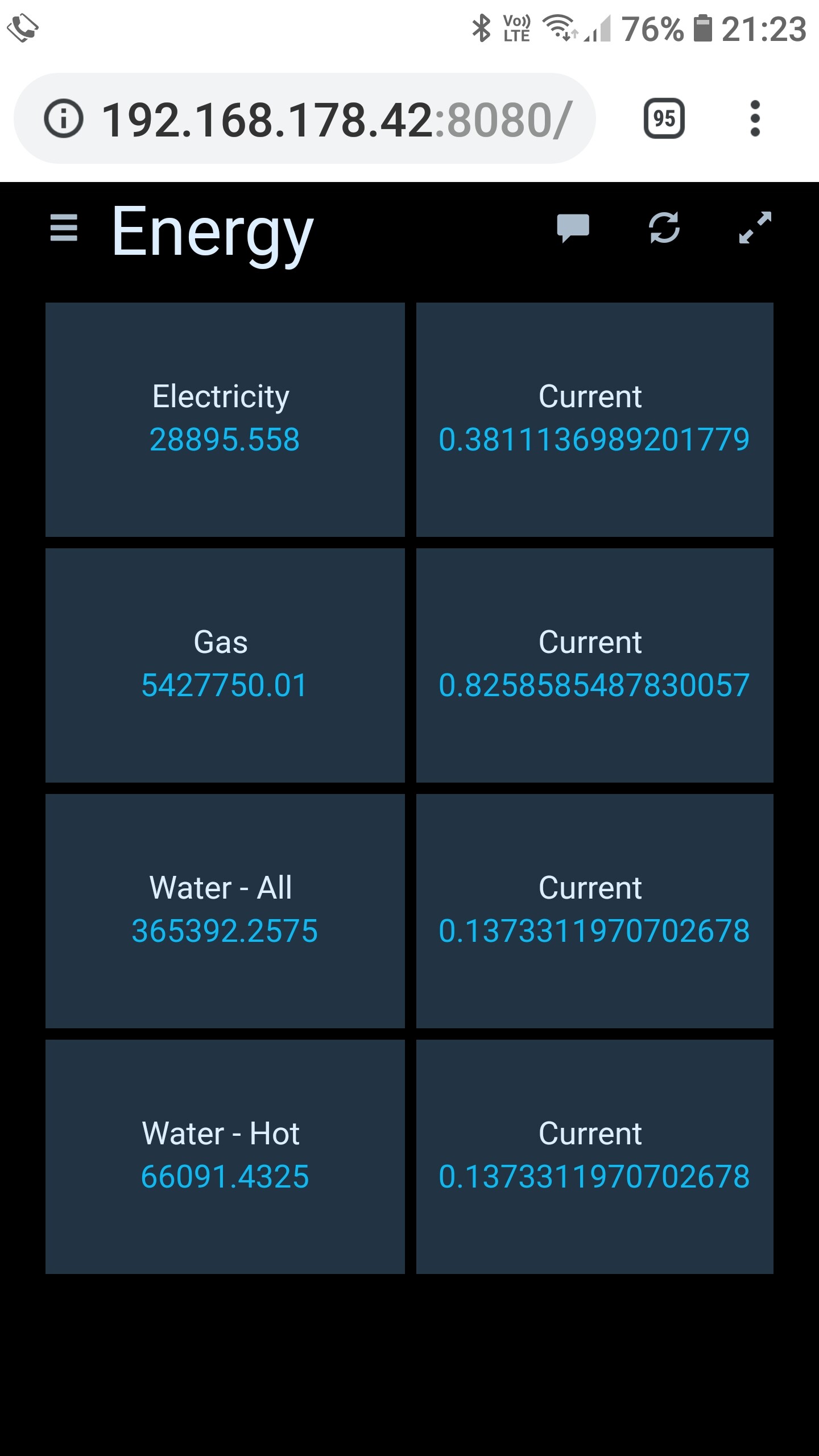

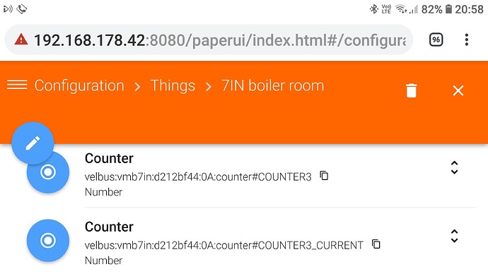

Now i have the counters! Super!
Thanks for the detailed explanation :slight_smile:
That’ll help other people :smile:
I’m really glad that you’ve got it working now :smile:
