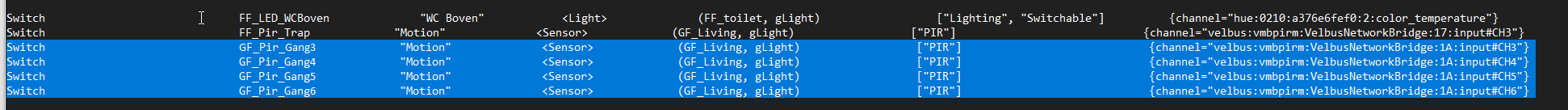

I created an item to be sure of all 4 channels, setup the same way to get the same outcome but for some reason i cannot get it to work.
