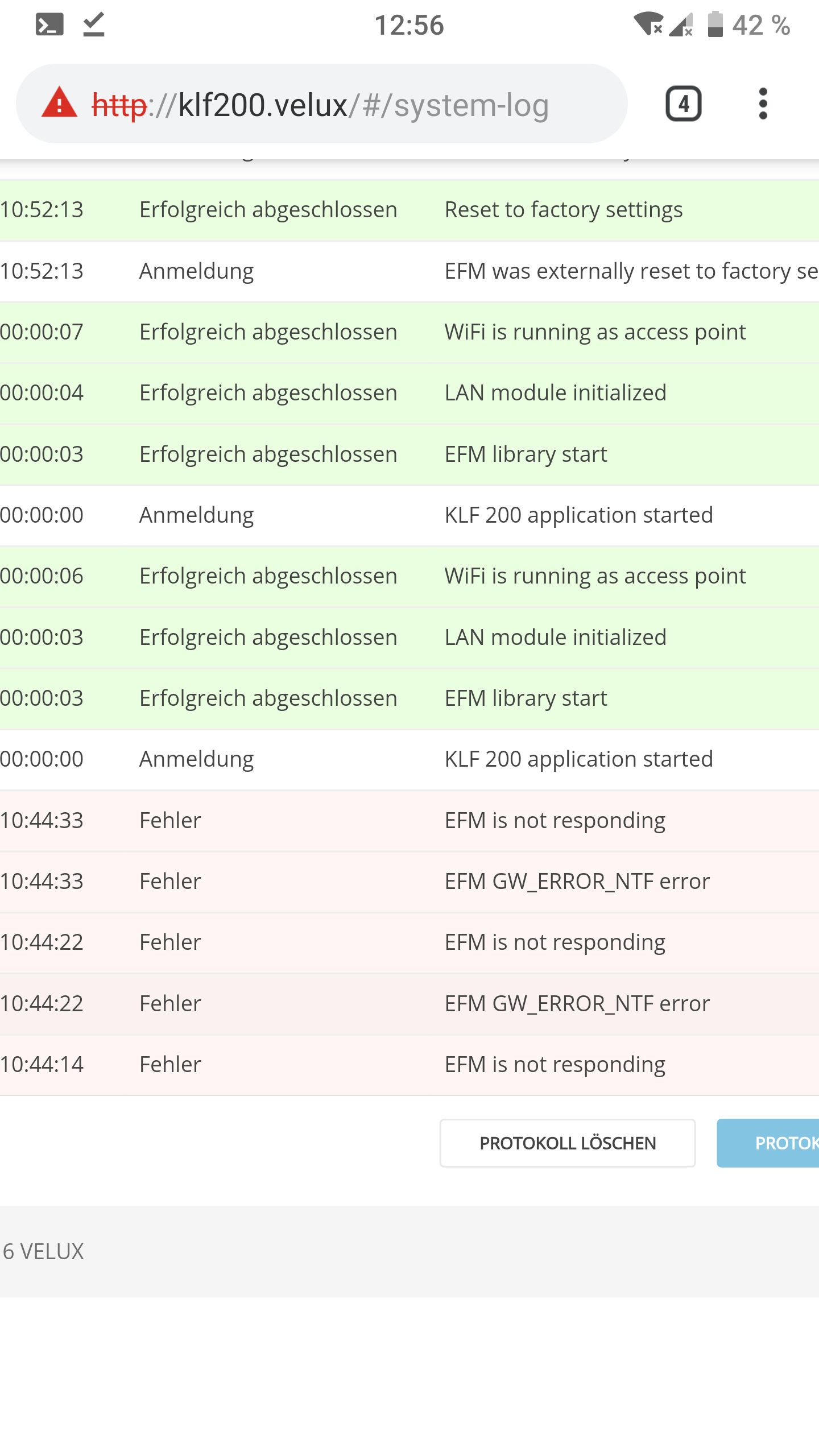

However, my problem has slightly changed, doing the factory reset (both by the reset button at the back and with the UI) has f**ked up the box completely: Now I can not even pair my existing actuators any more, the pairing process does not find any products (rollershutter remotes pressed at the settings button, rollershutters move up and down, KLF finds nothing).
Tried to re-update the firmware, too, but that was rejected as âtoo oldâ?!
Grrrr! Is there something more I can do? I guess Iâll have to look for a refund,!
I feared something like that :-(. Unfortunately neither the Velux WebUI nor the instructions for the KLF200 hint at something like that.
Is the procedure for Velux shutters the same as for Somfy shutters?
However, the error messages in the protocol after the firmware reset (in connection with the problems I had already before the reset) make me tend to be believe that there is something else wrong with the boxâŚ
