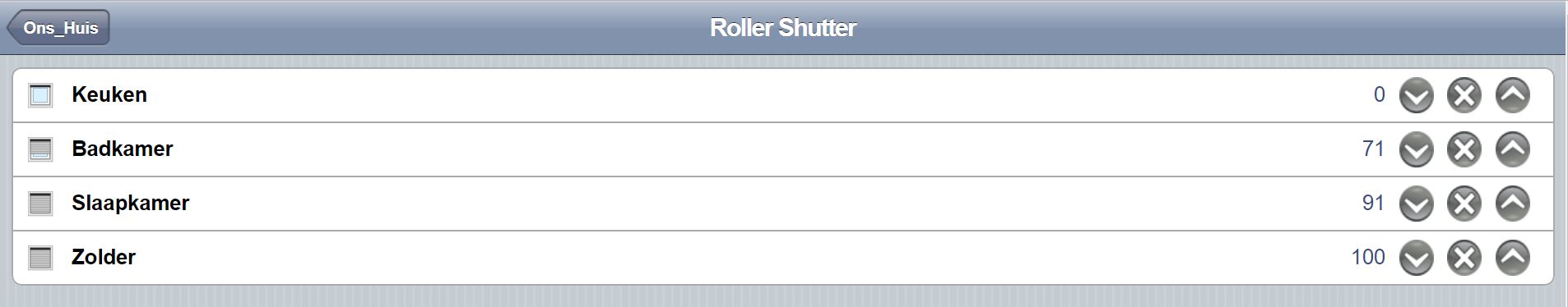

on my klf200 i have some scenes defined and the binding finds them as seen in the logmsg.
on the rollershutter named keuken i created 3 scenes also showing up in the logmsg.
on the sitemap i see the shutters but no scenes, resulting that i could only pushed the up or down button.
But how do i make the scenes visible there so that i could also choose scene “Keuken 75%” or others when i want to.

Hi Johnny-b,
I am on OH2, but it may be the same for you. I have the scenes defined in the items file as well and then added to the sitemap accordingly:
// Velux Scene channels
Switch  V_DG_ALL_50   "Velux DG All 50% open"   <blinds>  (gV)         { velux="thing=scene;channel=action#All_50"}
Switch  V_DG_All_Closed "Velux DG All closed"<blinds>  (gV)       { velux="thing=scene;channel=action#All_Closed" }

2019-07-16 14:44:16.038 [TRACE] [.binding.velux.internal.VeluxBinding] - internalReceiveUpdate(RS2,0) called.
2019-07-16 14:44:16.039 [TRACE] [ing.velux.things.VeluxExistingScenes] - isRegistered(V_Shutter_2_000) returns false.
2019-07-16 14:44:16.041 [TRACE] [.velux.handler.VeluxBridgeHandlerOH1] - handleCommandOnChannel(): execution scene null.
2019-07-16 14:44:16.046 [WARN ] [org.apache.karaf.services.eventadmin] - EventAdmin: Exception during event dispatch [org.osgi.service.event.Event [topic=openhab/command/RS2] {item=RS2, bridgemarker=true, command=UP, timestamp=1563281055974} | {org.osgi.service.cm.ManagedService, org.osgi.service.event.EventHandler}={service.id=361, service.bundleid=233, service.scope=bundle, event.topics=openhab/*, service.pid=org.openhab.velux, component.name=org.openhab.binding.velux.binding, component.id=220} | Bundle(org.openhab.binding.velux_1.14.0.201907092115 [233])]
	at org.openhab.binding.velux.handler.VeluxBridgeHandlerOH1.handleCommandOnChannel(VeluxBridgeHandlerOH1.java:547) ~[?:?]
	at org.openhab.binding.velux.internal.VeluxBinding.internalReceiveCommand(VeluxBinding.java:223) ~[?:?]
	at org.openhab.core.binding.AbstractBinding.receiveCommand(AbstractBinding.java:94) ~[?:?]
	at org.openhab.binding.velux.internal.VeluxBinding.receiveCommand(VeluxBinding.java:207) ~[?:?]
	at org.openhab.core.events.AbstractEventSubscriber.handleEvent(AbstractEventSubscriber.java:45) ~[?:?]
	at org.apache.felix.eventadmin.impl.handler.EventHandlerProxy.sendEvent(EventHandlerProxy.java:415) [3:org.apache.karaf.services.eventadmin:4.2.1]
	at org.apache.felix.eventadmin.impl.tasks.HandlerTask.runWithoutBlacklistTiming(HandlerTask.java:82) [3:org.apache.karaf.services.eventadmin:4.2.1]
	at org.apache.felix.eventadmin.impl.tasks.SyncDeliverTasks.execute(SyncDeliverTasks.java:104) [3:org.apache.karaf.services.eventadmin:4.2.1]
	at org.apache.felix.eventadmin.impl.tasks.AsyncDeliverTasks$TaskExecuter.run(AsyncDeliverTasks.java:166) [3:org.apache.karaf.services.eventadmin:4.2.1]
With this being my items config
Group:Switch:OR(ON, OFF)    gV  "PushButton"
// Velux Scenes
Switch  V_1_S_OPEN   "Velux Rolladen open"       (gV)    { velux="thing=scene;channel=action#V_Shutter_1_000" }
Switch  V_1_S_SUNNY  "Velux Rolladen sunny"      (gV)    { velux="thing=scene;channel=action#V_Shutter_1_090" }
Switch  V_1_S_CLOSED "Velux Rolladen closed"     (gV)    { velux="thing=scene;channel=action#V_Shutter_1_100" }
Switch  V_2_S_OPEN   "Velux Rolladen open"       (gV)    { velux="thing=scene;channel=action#V_Shutter_2_000" }
Switch  V_2_S_SUNNY  "Velux Rolladen sunny"      (gV)    { velux="thing=scene;channel=action#V_Shutter_2_090" }
Switch  V_2_S_CLOSED "Velux Rolladen closed"     (gV)    { velux="thing=scene;channel=action#V_Shutter_2_100" }
Switch  V_3_S_OPEN   "Velux Rolladen open"       (gV)    { velux="thing=scene;channel=action#V_Shutter_3_000" }
Switch  V_3_S_SUNNY  "Velux Rolladen sunny"      (gV)    { velux="thing=scene;channel=action#V_Shutter_3_090" }
Switch  V_3_S_CLOSED "Velux Rolladen closed"     (gV)    { velux="thing=scene;channel=action#V_Shutter_3_100" }
Switch  V_4_S_OPEN   "Velux Rolladen open"       (gV)    { velux="thing=scene;channel=action#V_Shutter_4_000" }
Switch  V_4_S_SUNNY  "Velux Rolladen sunny"      (gV)    { velux="thing=scene;channel=action#V_Shutter_4_090" }
Switch  V_4_S_CLOSED "Velux Rolladen closed"     (gV)    { velux="thing=scene;channel=action#V_Shutter_4_100" }
Switch  V_5_S_OPEN   "Velux Rolladen open"       (gV)    { velux="thing=scene;channel=action#V_Shutter_5_000" }
Switch  V_5_S_SUNNY  "Velux Rolladen sunny"      (gV)    { velux="thing=scene;channel=action#V_Shutter_5_090" }
Switch  V_5_S_CLOSED "Velux Rolladen closed"     (gV)    { velux="thing=scene;channel=action#V_Shutter_5_100" }
Switch  V_6_S_OPEN   "Velux Rolladen open"       (gV)    { velux="thing=scene;channel=action#V_Shutter_6_000" }
Switch  V_6_S_SUNNY  "Velux Rolladen sunny"      (gV)    { velux="thing=scene;channel=action#V_Shutter_6_090" }
Switch  V_6_S_CLOSED "Velux Rolladen closed"     (gV)    { velux="thing=scene;channel=action#V_Shutter_6_100" }
// Velux Bridge parameters
String  V_FIRMWARE  "Firmware [%s]"                 { velux="thing=bridge;channel=firmware" }
String  V_STATUS    "Status [%s]"                   { velux="thing=bridge;channel=status" }
String  V_CHECK     "Velux Config Check [%s]"           { velux="thing=bridge;channel=check" }
// Velux Shutters
Rollershutter RS1  "Velux Rolladen 1 [%d]"   { velux="thing=bridge;channel=shutter#0,V_Shutter_1_000,90,V_Shutter_1_090,100,V_Shutter_1_100"}
Rollershutter RS2  "Velux Rolladen 2 [%d]"   { velux="thing=bridge;channel=shutter#0,V_Shutter_2_000,90,V_Shutter_2_090,100,V_Shutter_2_100"}
Rollershutter RS3  "Velux Rolladen 3 [%d]"   { velux="thing=bridge;channel=shutter#0,V_Shutter_3_000,90,V_Shutter_3_090,100,V_Shutter_3_100"}
Rollershutter RS4  "Velux Rolladen 4 [%d]"   { velux="thing=bridge;channel=shutter#0,V_Shutter_4_000,90,V_Shutter_4_090,100,V_Shutter_4_100"}
Rollershutter RS5  "Velux Rolladen 5 [%d]"   { velux="thing=bridge;channel=shutter#0,V_Shutter_5_000,90,V_Shutter_5_090,100,V_Shutter_5_100"}
Rollershutter RS6  "Velux Rolladen 6 [%d]"   { velux="thing=bridge;channel=shutter#0,V_Shutter_6_000,90,V_Shutter_6_090,100,V_Shutter_6_100"}
