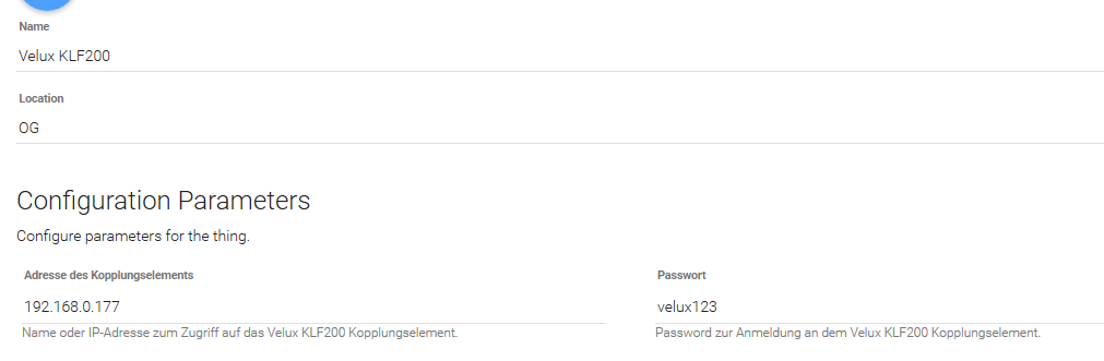

i have installed velux snapshot 2.3.0 and add a thing “Velux KLF200” via paper ui. then i have define the
ip adress in paper ui.
grafik
my actually problem is, that the velux device in openhab always switch to offline.

The gateway does not allow you to login in. Quoting the manual (KLF 200 API Version: 3.16, io-homecontrol® Gateway 02-11-2018):
Client must authenticate after TLS socket has been established, using a password.
The default password is the same as Wi-Fi password written on back side of KLF200.
The user can change the password. The password is reset to Wi-Fi password if factory
reset is requested.
Question: did you change the password via the web interface?
