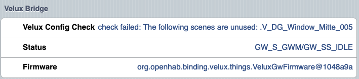

Also, the bridge-items look like this:
Firmware          -
Status            GW_S_GWM/GW_SS_IDLE
Congif Check      -
Is that expected?

Hello Mikkel,
thank you the feedback and the detailled extracts of the startup log. In fact, most entries look fine, but we’ll have to dig into the following lines:
2019-04-22 16:23:18.505 [WARN ] [g.velux.things.VeluxExistingProducts] - update() failed as actuator (with index 0) is not registered.
2019-04-22 16:23:18.507 [WARN ] [g.velux.things.VeluxExistingProducts] - update() failed as actuator (with index 1) is not registered.
2019-04-22 16:23:18.510 [WARN ] [g.velux.things.VeluxExistingProducts] - update() failed as actuator (with index 2) is not registered.
2019-04-22 16:23:18.513 [WARN ] [g.velux.things.VeluxExistingProducts] - update() failed as actuator (with index 3) is not registered.
Could you please check the definition of the gateway items? The output within the sitemap should look like:
Best regards, Guenther
