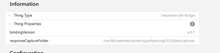

I assume you have the 4.0.1 version of the plugin, you can check in the bridge properties.
I had released version 4.0.1 because of this problem, and I thought I had fixed it after many hours debugging. What happens is that OpenHAB actually uninstalls the binding on startup.
Unfortunately, I look at my own installation this morning, and discover that it had a restart due to an OS update, and it is still doing it. I will have to look into it again.
thanks for your quick response!
It is true, it’s the 4.0.1:

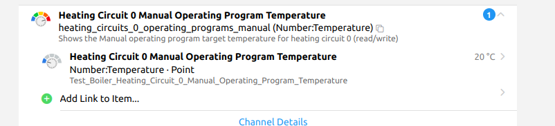

Hi, found that for my vitodens 100 manual-mode setpoint temp is missed in channels list.

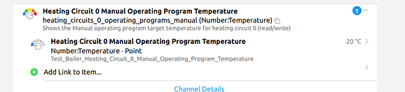

heating_circuits_0_operating_programs_manual channel, is was there for previous versions )
Hi there,
I have not seen the actual temperature value populated for operating.programs.manual in any sample json files I’ve been sent, as far as I know it isn’t populated.
However, by manually editing a test json file, I was able to verify that if the temperature value is populated similar to other programs, it will be reported by the binding:
So therefore, I think that it may have been reported by the API once before, but no longer is. I have a Vitodens 100-W and my boiler does not report it and never has, to my knowledge.

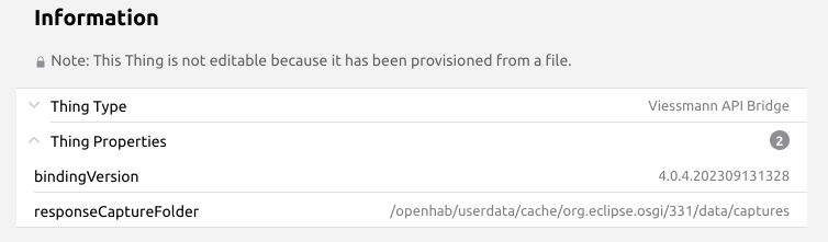

Enable the following setting on the Viessmann Bridge:
Then under the thing properties the responseCaptureFolder property will tell you where to find the json capture files
If you go to that folder then send me those files, I can see if the feature is reported or not. (And possibly fix any other missing features if they are not shown)

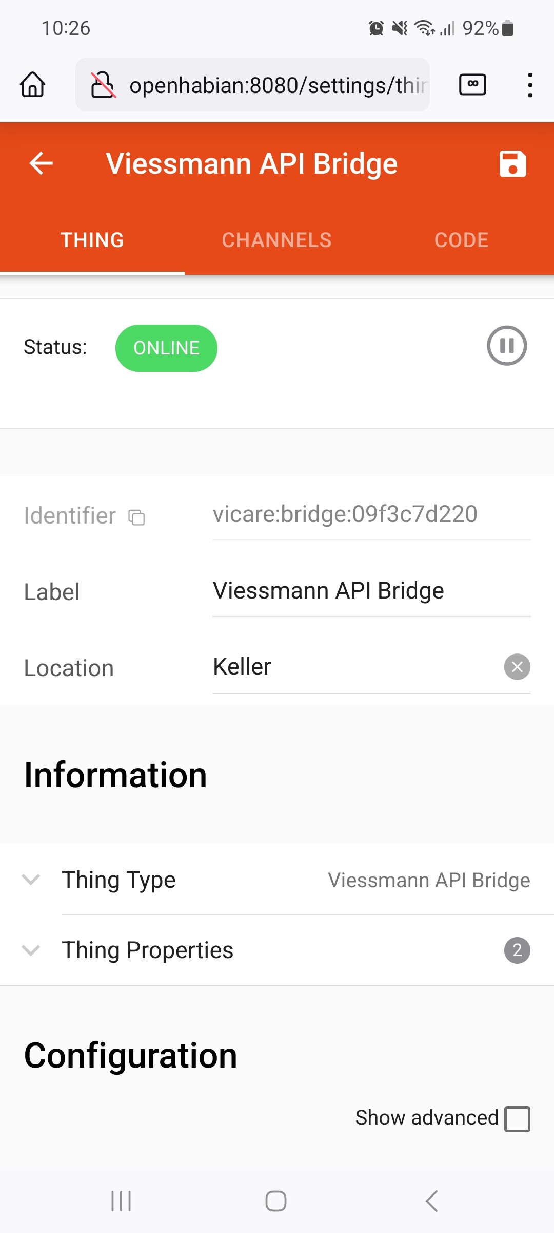

I did a successful confuguration of binding, status green, but nothing in the inbox. What have i to do next? Thanks
If you’ve already signed up for the API, authorised the binding, then it should autodiscover your devices, it will poll for new ones periodically, pausing and restarting the bridge may nudge it to rescan. However I expect by now they should have already appeared. What does your binding list as discovered devices in the vicare/setup page?
Screenshot_20231119_102608_Firefox
Mhmm, successfully configured and running since days, but nothing in inbox. I didn’t reboot the raspberry.
