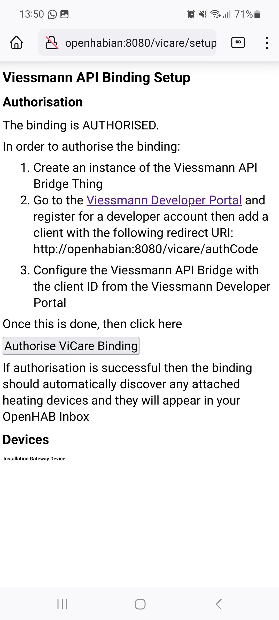

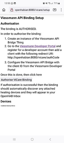

If you go to this page at /vicare/setup on your server, what does it say?
I thought, authorization was successfull
If it doesn’t list anything on that page then the API isn’t reporting any devices. Is this account the same one your heating is registered with?
This is embarrassing. I mixed up my emailaccounts during registration. The API works perfect. Many thanks!

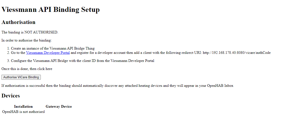

i set up a fresh installation of openhabian 4.1.1 on my Raspberry Pi 3 Model B. Now i want to install the vicare binding. I placed the .kar file into the addons folder, but i cant add the Viessmann API Bridge. It dosent shows the binding, if i go to Settings–>Things–>Add. If i open http://192.168.178.40:8080/vicare/setup, im able to authorise the Viessmann API.
Maybe somewone has any idea whats wrong.

Afaik you don’t have to manually install the vicare binding.
Just do it via addons store (and don’t forget to firstly remove the manually dropped file)
And of course openHAB is not authorized yet :slight_smile:

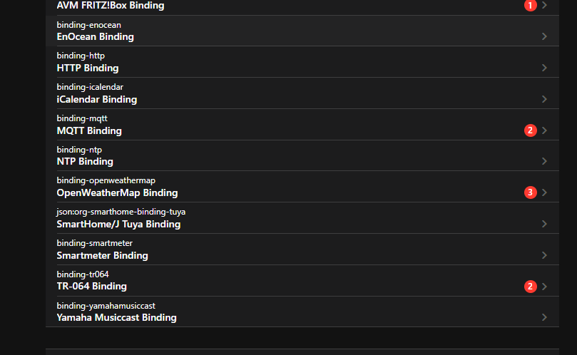

How to do it via addons store, I can’t find anything there? :thinking:
Edit:
Okay, i found it. thanks :partying_face:
Where / How did you find it?
I found IT at Addon Store → Community Marketplace
