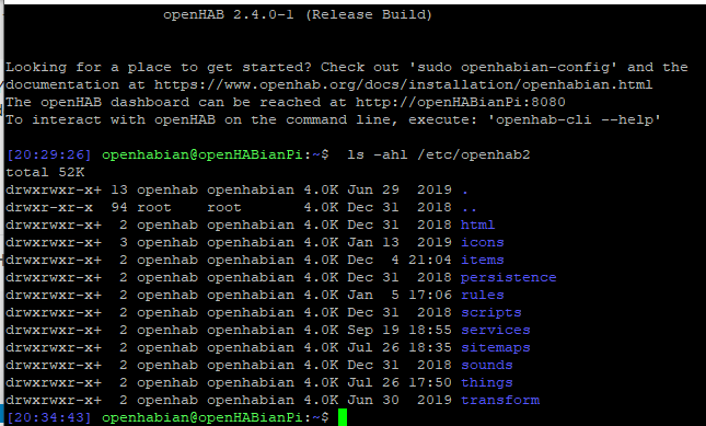

However to H102’s point you will need to use vim or nano (or some editor) to fix the Samba share, chances are your share is owned by a different user of the system than what you are connecting with for the share.
If you do a ls -ahl /etc/openhab2 you will get a dump of the directory with the owner and group (openhab or openhabian). You can have Samba connect as that owner so gain write permissions to the files you are looking to edit.

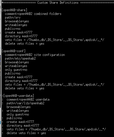

For samba share I have the following in my smb.config file.

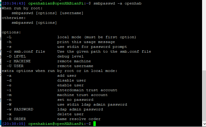

You need to connect using credentials of user openhab and its password - whatever that is.
Before you do so, make sure you add openhab to the samba password database which is not the same as the system passwd file.
command:when ssh into your openhab box:
smbpasswd -a openhab
Then try to connect to share again

I did see that my code (or script, not sure which is the correct term) did not mathc that of H102 so I updated it to match.
I did try ls -ahl /etc/openhab2 as anonymous.one suggested and it show this
But I really do not know what it means or what I would do with it.
As tillykeats commented I use
and I get this
The fact that I do not see a user name or password makes me wonder if I do not have something set up? Or do I need to nano int this as well and change these?
At that point, VS would look somewhere for this info? How does that get set up?
You may need to use sudo smbpasswd -a openhab
What does that mean? I did copy and paste it in, but iam not sure what to do with it.

Well yes your pictures show it.
Run sudo openhab-cli reset-ownership first.
Use sudo openhabian-config and change your password(s) from the menu option 34 next, including the Samba one of course. Also run menu option 13 to re-deploy your share.
Reboot and reconnect to the share from your Windows box.

The OP ended up solving the issue and posting his resolution, they ended up using ‘force user’ mapping the anonymous user to Linux user. As you can see in your screenshot of the ls -ahl ‘openhab’ is the user who owns the directory structure.
