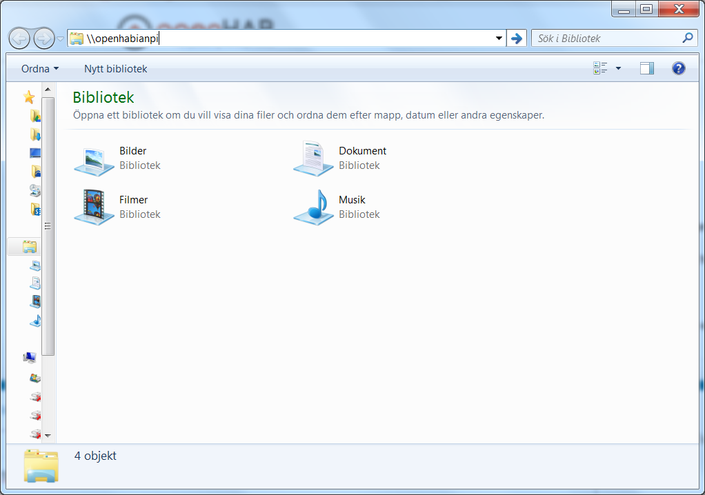

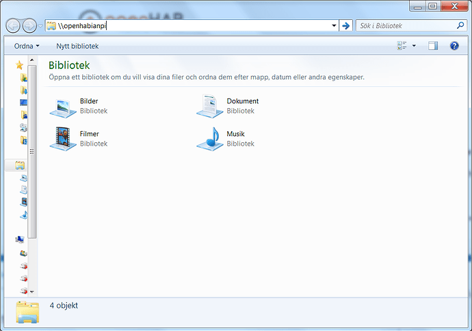

First try to just type \\openhabianpi in the folder field in windows explorer and see if it finds anything.
Edit: I’m on windows 7 on this computer, but should look about the same on 10.
