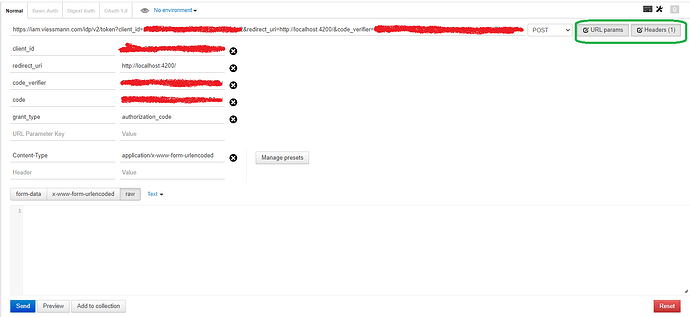

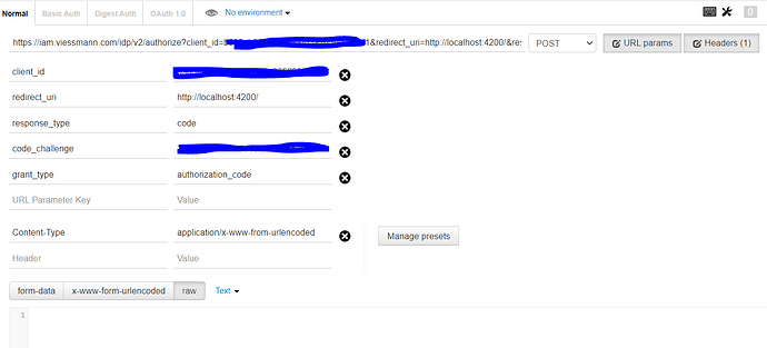

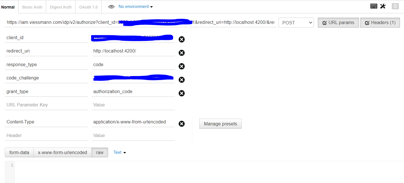

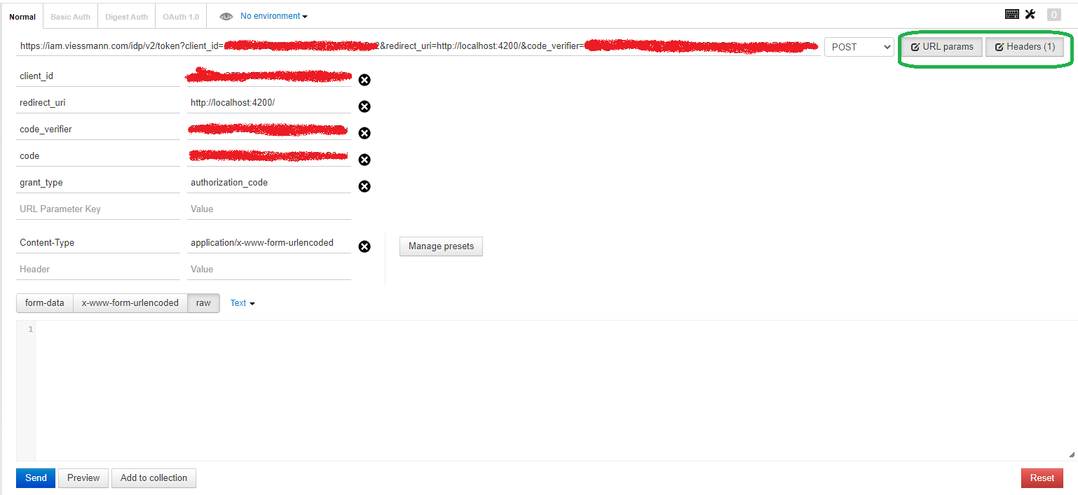

You need an account on the Viessmann Developer Portal, I think your credentials from the ViCare App should do.
Getting an API Key
Do all steps as written under the Authentication Tab on the browser ( I used Postman to create the http post and get requests). If you have requested to Refresh your API once, you can use the RefreshToken in an openHAB rule that runs every hour to refresh your API key. My used rule (ECMA) for this looks like:
Edit: NOTE: The code posted by @AndreasBerz is better, I am going to use his code!
