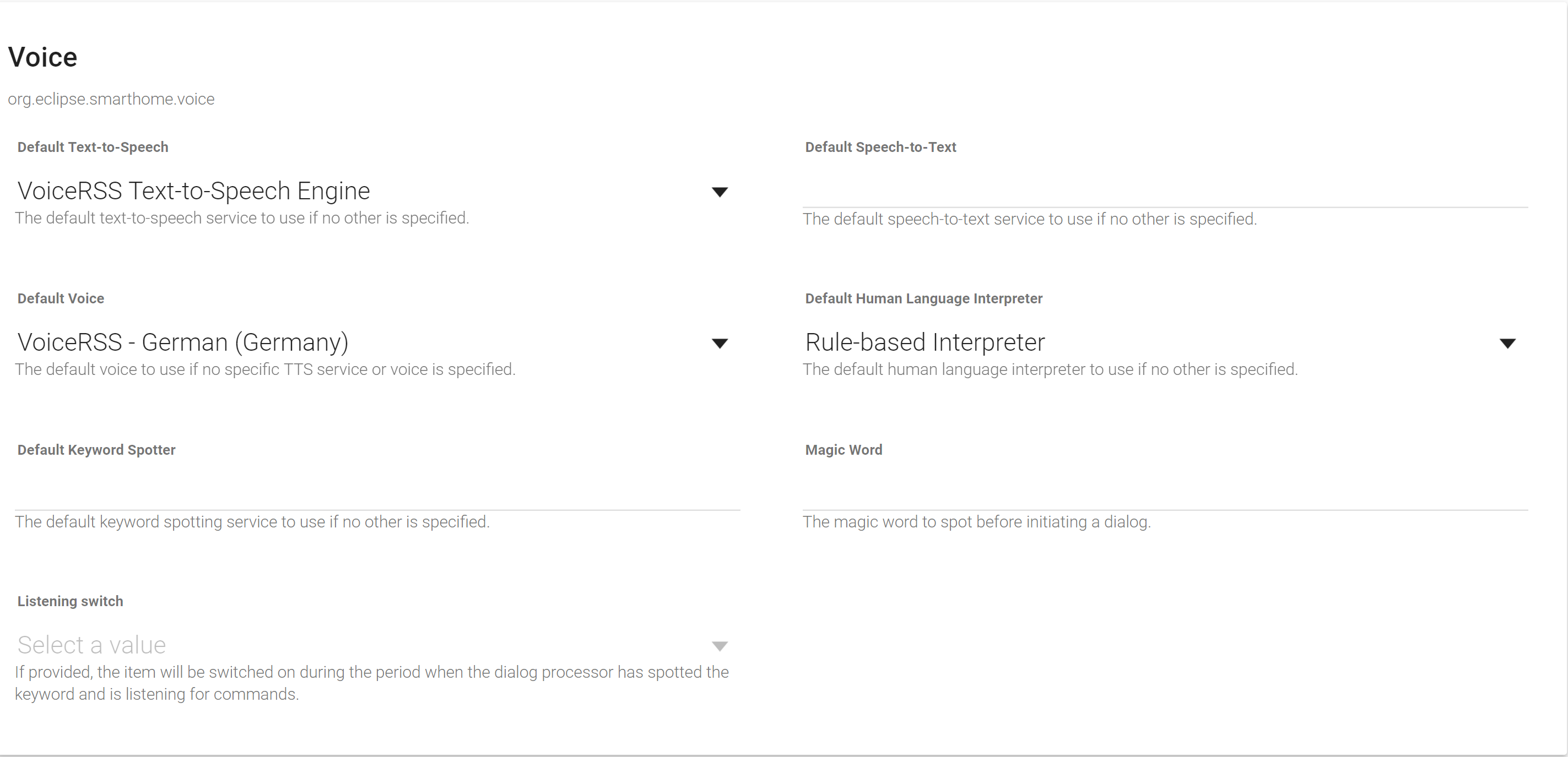

  • put the api Key in the config (voicerss.cfg at conf\services) AND in the PaperUI at Configuration, Services (just to be sure)
  • configurated Voice Service at PaperUI - Configuration - System to use VoiceRSS and set Language to “de”
For my understanding that was everything to do for using VoiceRSS with OpenHAB.

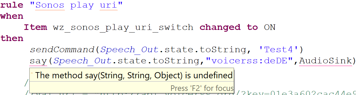

my error is a little bit different now. (without changing anything) when i restart openhab and run the rule i see the files created in the voicerss cache directory. but every other run from the rule does not result in new files (even when i change the text for tts).
here a picture of my designer, because it always tells me say is undefinied.
what is going on here? ^^
Yes, the actual say command is the same as yours, however my item gets set via a GUI and NOT using a sendCommand within the rule (that command takes time and since it is run in a different thread it might not be ready yet. Hence your observed “Null”).
The new behaviour you see needs to be clearified. I would have expect that an old text would have been used (and therefor not crwate a new file). Try to put a logInfo between the sendCommand and say in order to get a feedback of the actual state.
However I see no reason for setting a new state to an item within a rule and use that state afterwards for the say command. Whatever you set the item.state to you can directly hand to the say command.
The designer is known for such false reprts!
