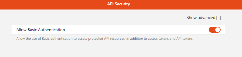

on openHAB-Side
Make sure to activate Allow Basic Authentication in the API Security settings.
