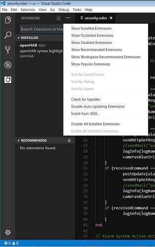

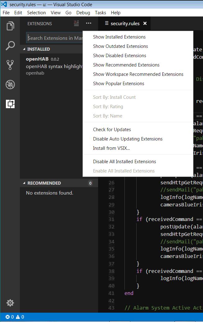

I’m sorry I did not get how did you install the extension on MacOs
@Dominic_Bonneau I believe it is the same for osx as it is for windows.
Open the extensions pane on the left, then open the options menu (three dot) link at the top. Choose to install from VSIX and then navigate to where you saved the vsix file.
