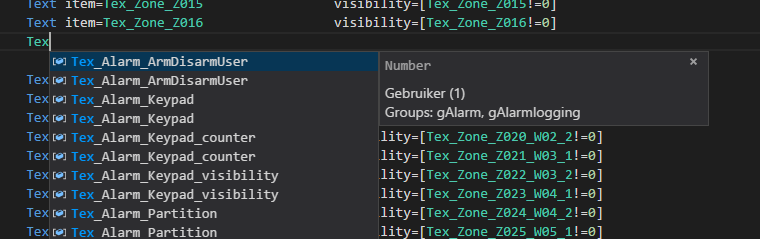

Same for rules btw:
I’m still new to VS Code, so I’m not sure what to except from autocomplete. But so far, I see it only completes item-names, and not syntax related stuff.
