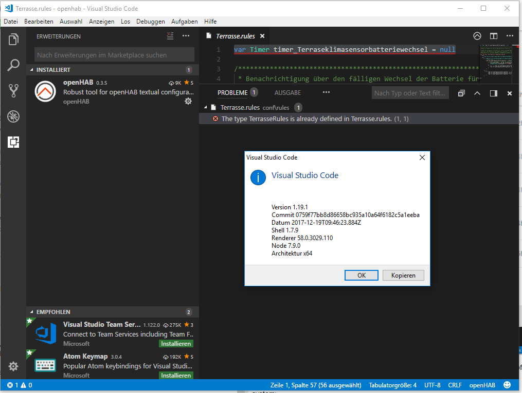

ive noticed following problems since upgrade to oh 2.2.0 rel:
every first statement of each rule-file is marked as a problem with this strange hint of a “type is already defined in..” ive never defined. no matter whether the first statement is a var or an import.
is there something im missing creating a rules-file? some syntax issues or maybe a permission prob?
system:
synology dsm 6.1.4-15217-3
openhab as docker container based on latest “2.2.0-arm64-debian image” from 21.12.17
@rikky could you please submit a new issue on ESH repository? @sjka would you mind taking a look?
