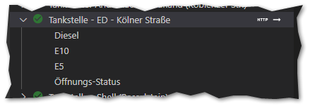

I am missing the icons in front of the items and things when displaying them on the lefthand sidebar.
See this screenshot:
Looking at the examples in the README I would expect icons like a folder (for groups) and specific ones for different item types in front of the text.
What could be missing? The connecting to the openHAB instance is working (the actual values are displayed).

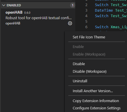

You need to select the openHAB theme in your “Set File Icon Theme” settings:
Thanks for the reply!
Selecting the openHAB theme did give me the icons for all the openHAB files, however the icons for the items and things remain blank (I did a restart of VSC!).

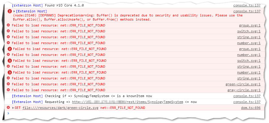

It indeed tries to laod the icons, but they are not found.
Paths look good so far.

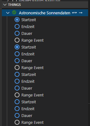

Please notice that i have adpated it only for things on root tree level for testing.
If you expand some things the corresponding channels will still have no icon.
Example:
