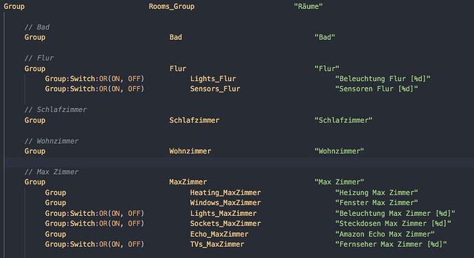

Another feature which is now also supported by the tool is the group formatting.
So the tool recognizes tabs in front of group designators and leaves them as they are. So that’s how you can generate group and sub-groups of that group. They are separated visually:
