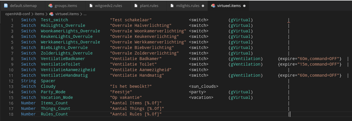

Hi @Max_Bec,
Thanks for this tool, saves me a lot of time! I wish I found out about it 2 years ago.
What I noticed is that it puts 1 or more tabs at the end of each line.
@stfn82, thank you for the feedback. Glad to hear that you enjoy the extension.
I am already aware of the problem. And solving it is the first point on my bucket list. So expect a fix soon!
The fix was easier than expected. Version 1.3.9 should be online in a few minutes and fix the bug.
Wow that’s fast :smile:
I can confirm that it’s fixed :+1:
