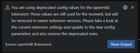

VSCode - Deprecated?
All, Any idea why this is all of a sudden coming up. Doesn’t seem to effect anything, currently using OH 2.5.

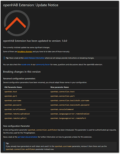

This is probably because your VSCode openHAB addon has been upgraded to ver. 1.0.0
You have to adjust your config values.
See “openHAB update notice” in VSCode for details.
As @kristofejro already said.
We have changed some config parameters to an improved structure and will replace the outdated ones at some point.
This is why the message showed up.

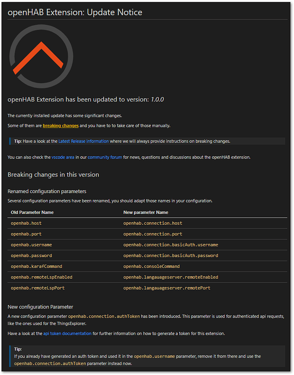

You can open the update notice with cmdshiftp and then seraching for openHAB update notice.
It will tell you which parameters have changed and how the new ones are called.
A simple rename to the new parameter names should then solve this warnings.

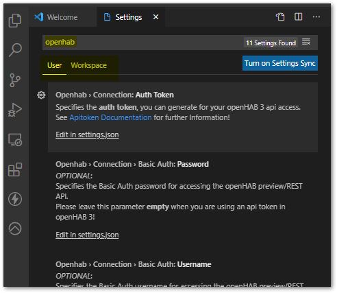

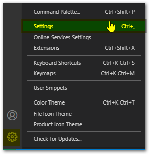

You can go to settings (while having your openhab folder opened):
And search for openhab.
In my case there are settings available on user and workspace level (which are the main places to configure something).
I would then switch to json view with the
button and check if you have anything configured.
The json view will show default available settings and tabs for each of the config locations that are aavailable/used in your case.
You can then check for the outdated values from the update notice and replace them with their new namings.

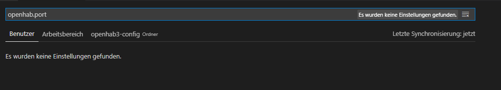

I got a similar issue.
VSCode says:
Usage of deprecated config => openhab.port <= detected.
But on all three levels the parameter was not found (because i already removed it):
The same problem remains in my installation! Any solution?
